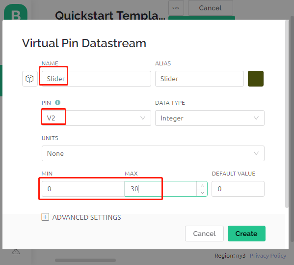

  1. Create a Datastream of type Virtual Pin on the Datastream page as the value modified by the Slider widget added later or code. Set the DATA TYPE to Integer and MIN and MAX to 0 and 30.
    ../_images/sp220610_104330.png

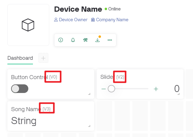

  3. Go to the Wed Dashboard page, drag a Switch widget and set Datastream to V0 (V0 is already set in 2. Get Data from Blynk); drag a Label widget and set it to V3; drag a Slider widget and set it to V2.
    ../_images/blynk_music_cloud.png
Your virtual pins may be different from mine, yours will prevail, but you need to modify the corresponding pin number in the code.
