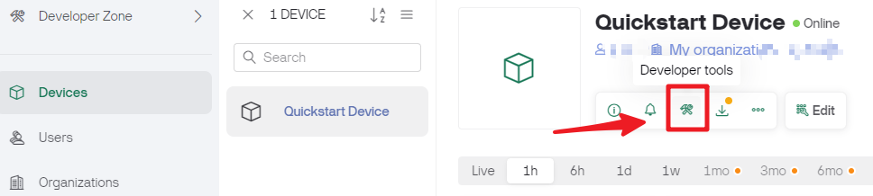

  2. Click the devices page and you will see the new device you just created. Then, click developer tools.

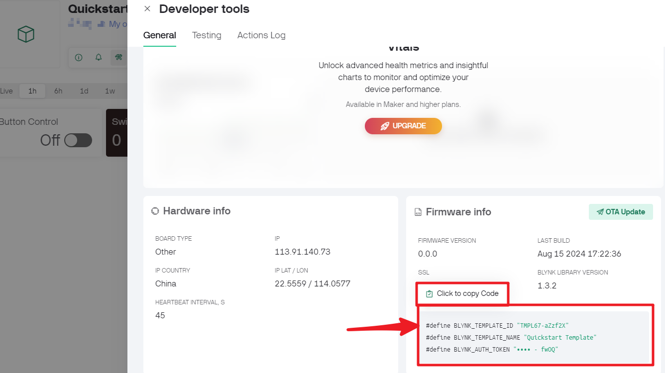

  3. And you will see TEMPLATE_ID, DEVICE_NAME and AUTH_TOKEN on the Firmware info, and you will need to copy them later.
    ../../_images/blynk_copy_firmwareinfo.png
  4. Open the 1.connect.ino file under the path of 3in1-kit\iot_project\1.connect. Or copy this code into Arduino IDE.
  5. Replace the following three lines of code that you can copy from your account’s Firmware info These three lines of code will allow your R3 board to find your blynk account.
    #define BLYNK_TEMPLATE_ID "TMPLxxxxxx"
    #define BLYNK_DEVICE_NAME "Device"
    #define BLYNK_AUTH_TOKEN "YourAuthToken"

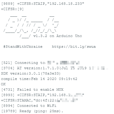

  7. Upload the code to the R4 board, then open the serial monitor and set the baud rate to 115200. when the R4 board communicates with Blynk successfully, the serial monitor will show the ready character.
    ../../_images/blynk_connect_network.png
    If the message ESP is not responding appears when you connect, please follow these steps.
    • Make sure the 9V battery is plugged in.
    • Reset the ESP8266 module by connecting the pin RST to GND for 1 second, then unplug it.
    • Press the reset button on the R4 board.
    Sometimes, you may need to repeat the above operation 3-5 times, please be patient.
