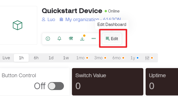

2. Edit Dashboard #. Go to the Quickstart Device you created earlier, click on the edit dashboard icon.
../_images/blynk_edit_dashboard.png

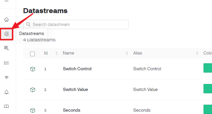

  1. Datastreams allow the widgets on Blynk and the code on the R3 board to recognize each other.
    ../_images/blynk_edit_datastream.png
  2. To experience the complete configuration process, remove all Datastreams from the Datastreams page.
    ../_images/blynk_edit_datastream_delete.png

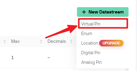

  3. Create a Datastream of type Virtual Pin, which will be used to control the LED using Blynk’s switch.
    ../_images/blynk_edit_virtualpin.png

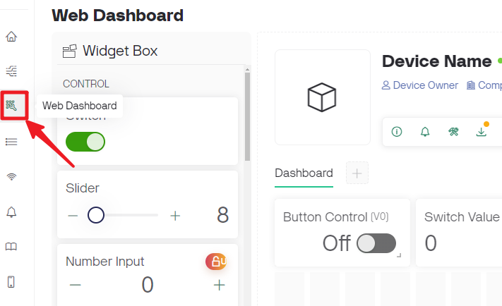

  5. Go to the Web Dashboard page.
    ../_images/blynk_edit_web_dashboard.png

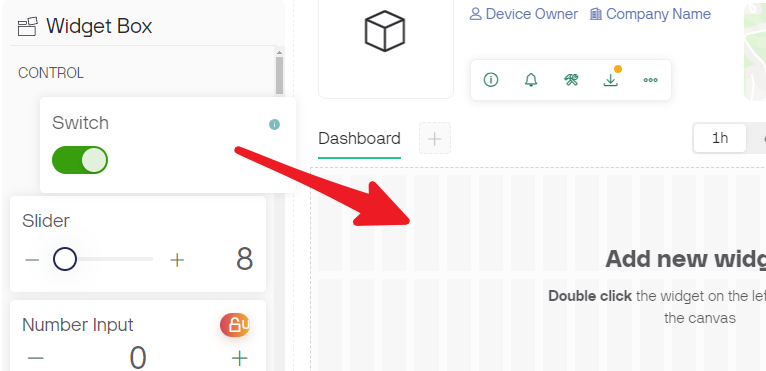

  7. Drag and drop a switch widget from the Widget Box on the left.
    ../_images/blynk_edit_drag_switch_widget.png

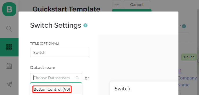

  9. Select Datastream as the one you set earlier.
    ../_images/sp220609_133741.png

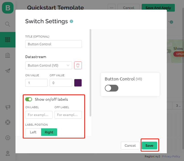

  10. After selecting Datastream, you will see a few custom settings, then press Save.
    ../_images/sp220609_133950.png

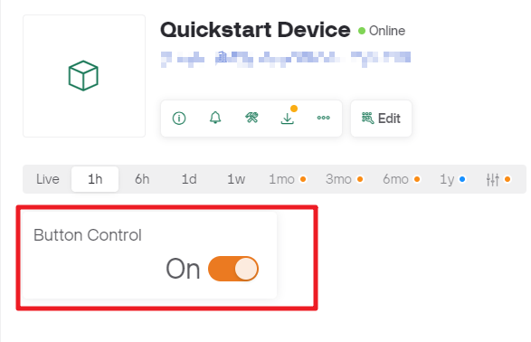

  5. Back at Blynk, you can see that the status has changed to online and you can now use the switch widget on blynk to control the LED connected to the R4 board.
    ../_images/blynk_button_on.png
