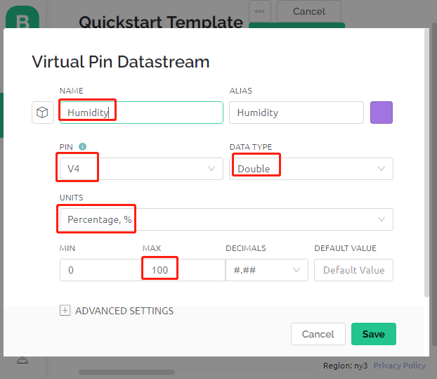

  1. For recording humidity values, create a Datastream of type Virtual Pin on the Datastream page. Set the DATA TYPE to Double and MIN and MAX to 0 and 100. Also set the units to Percentage, %.
    ../_images/sp220610_145748.png

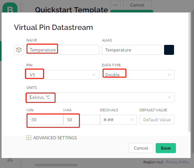

  2. Then create a Datastream of type Virtual Pin for recording the temperature. Set DATA TYPE to Double, MIN and MAX to -30 and 50, and units to Celsius, °C.
    ../_images/sp220610_145811.png
