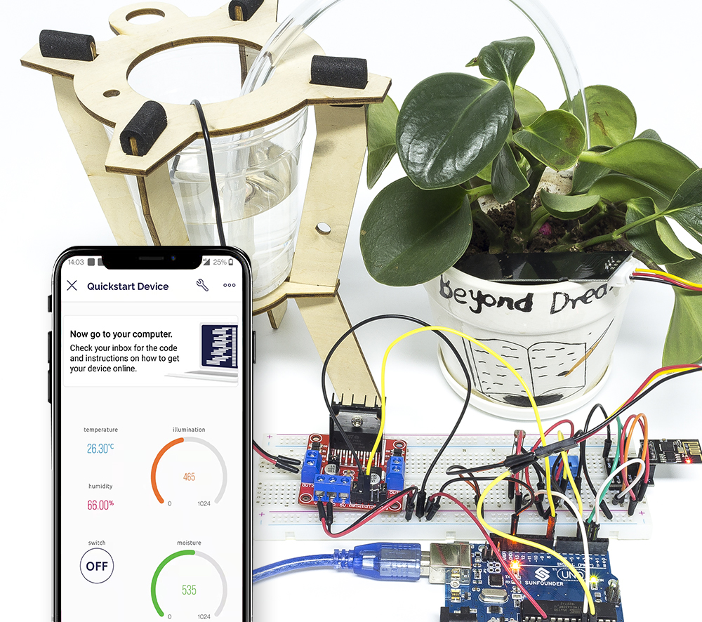

6. Plant Monitor¶
The purpose of this project is to create a smart watering system that detects the current temperature, humidity, intensity of light, and soil moisture and displays them on Blynk.
As soon as you turn on the Switch toggle in Blynk Cloud, the pump will start working and the plants will be hydrated.

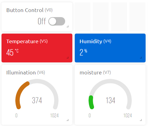

2. Edit Dashboard
  1. The data streams created in the previous projects need to be saved, and they will be used in this project as well.
  2. For recording soil moisture, create another Datastream of type Virtual Pin on the Datastream page. Set DATA TYPE to Integer and MIN and MAX to 0 and 1024.
    ../_images/sp220610_155221.png
  3. Now go to the Wed Dashboard page, drag 2 Label widgets and set their data streams to V4 and V5 respectively; drag 2 Gauge widgets and set their data streams to show V6 and V7 respectively; and finally drag a Switch widget and set its data stream to V0.
    ../_images/sp220610_155350.png

  4. Back to the Blynk, you will see the current temperature, humidity, light intensity, and soil moisture. You can let the pump water the plants if necessary by clicking the Button Control widget.
  5. If you want to use Blynk on mobile devices, please refer to How to use Blynk on mobile device?.
    ../_images/mobile_plant.jpg
