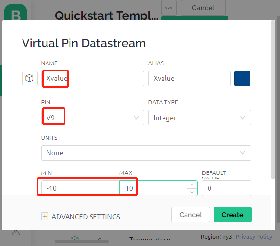

  1. Create a Datastream of type Virtual Pin on the Datastream page, to record the X-axis value of the joystick. Set NAME to Xvalue, DATA TYPE to Integer, and MIN and MAX to -10 and 10.
    ../_images/sp220613_164507.png

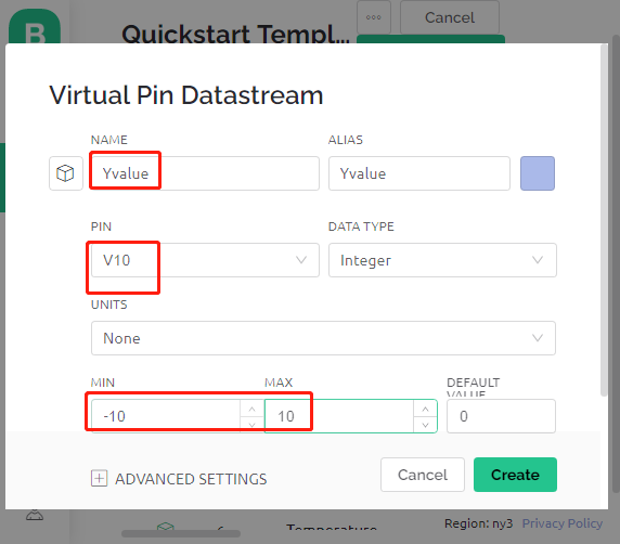

  2. Create a Datastream of type Virtual Pin to record the Y-axis value of the joystick. Set NAME to Yvalue, DATA TYPE to Integer, MIN and MAX to -10 and 10.
    ../_images/sp220613_164717.png

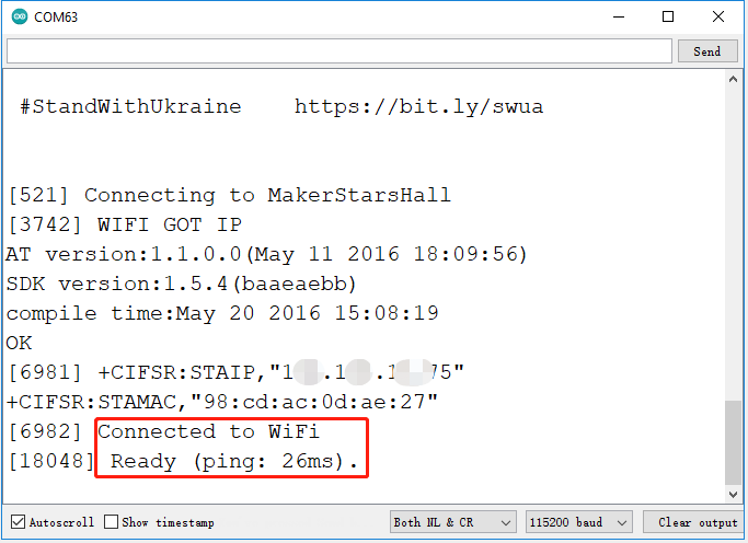

  4. Open the Serial monitor(set baudrate to 115200) and wait for a prompt such as a successful connection to appear.
    ../_images/2_ready.png
    If the message ESP is not responding appears when you connect, please follow these steps.
    • Make sure the 9V battery is plugged in.
    • Reset the ESP8266 module by connecting the pin RST to GND for 1 second, then unplug it.
    • Press the reset button on the R4 board.
    Sometimes, you may need to repeat the above operation 3-5 times, please be patient.

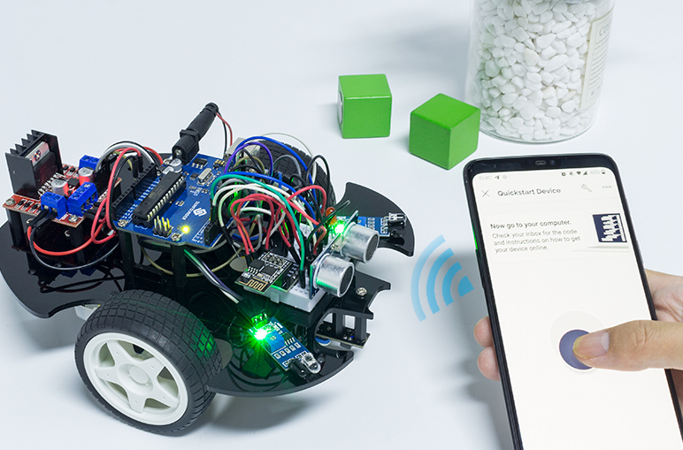

  5. Now unplug the USB cable and power the cart with a 9V battery alone, then wait for the LED to light up, representing that the car is connected to Blynk.
  6. Open Blynk on your phone and you can use the Joystick widget to control the movement of the car.
