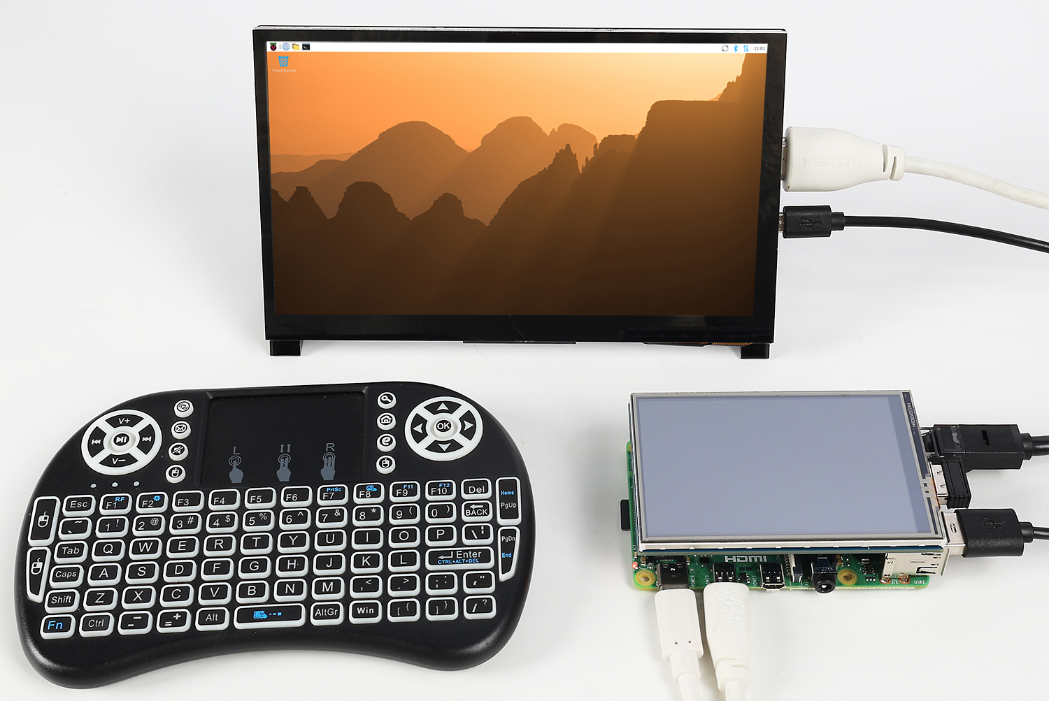

  1. Insert the microSD card into your Raspberry Pi.
  2. Connect the keyboard, mouse, and monitor.
  3. Power on your Raspberry Pi.

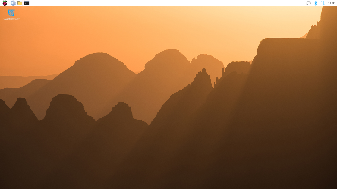

  4. After booting, the Raspberry Pi OS desktop will appear.
    ../_images/connect_all_rpios.jpg
  5. Open a Terminal to enter commands.
    ../_images/open_terminal.png
