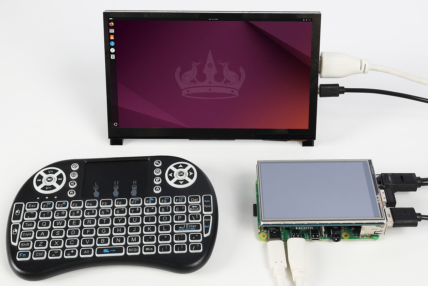

  1. Connect your Raspberry Pi to a monitor and power it on. Make sure an Ethernet cable is connected for network access.
    ../_images/connect_all_ubuntu.jpg
  2. Follow the on-screen instructions to complete the initial setup, including language, keyboard layout, region, username, and password.
  3. After setup is complete, log in using your username and password, then search for and open the Terminal.
