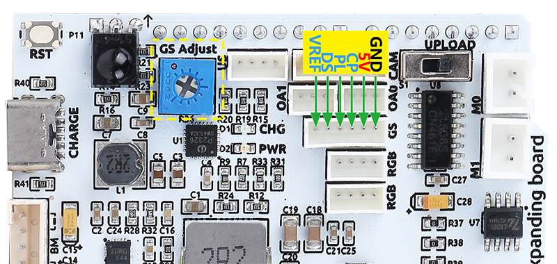

- Grayscale Module Related
Grayscale adjustment potentiometer: used to set the reference voltage for Omni grayscale module
Grayscale Port: Used to connect Omni Grayscale module.

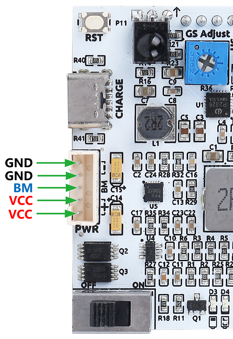

Battery Port
Here is the pinout diagram for the battery interface. The type is PH2.0-5P, and the power input range is 6.6V~8.4V.

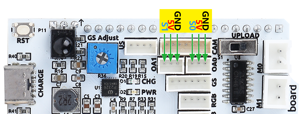

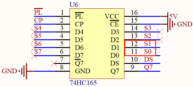

Obstacle Avoidance Port
Below is the pinout diagram of the two ZH1.5-3P obstacle avoidance ports.

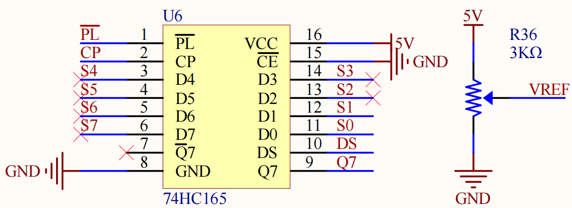

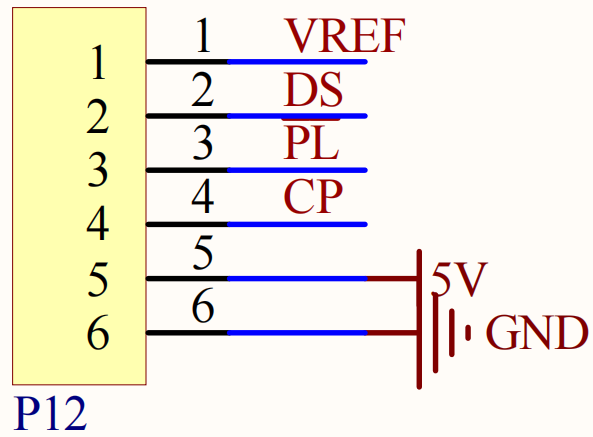

As shown in the circuit diagram, S1 and S0 refer to Q0 and Q1 on the 74HC165 chip. Two 74HC165 cascades transfer the data of the two IR obstacle avoidance modules and the grayscale sensor to the Arduino board. The first eight bits are grayscale sensor data, and the last two bits represent IR obstacle avoidance data.

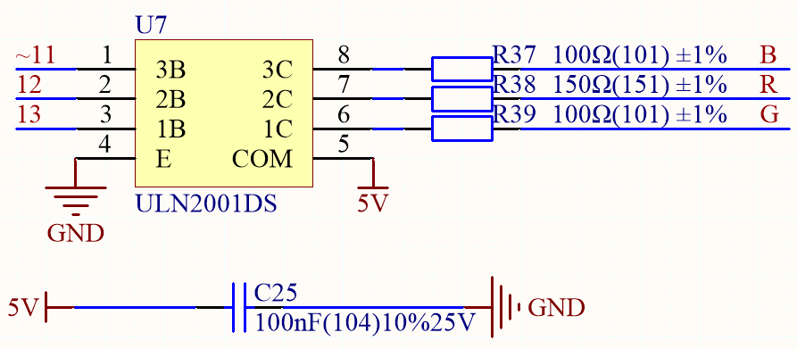

RGB LED Strip Port
Below is the pinout diagram of the two RGB LED Strip, they are connected in parallel and the pinouts are the same.
Here is the schematic.

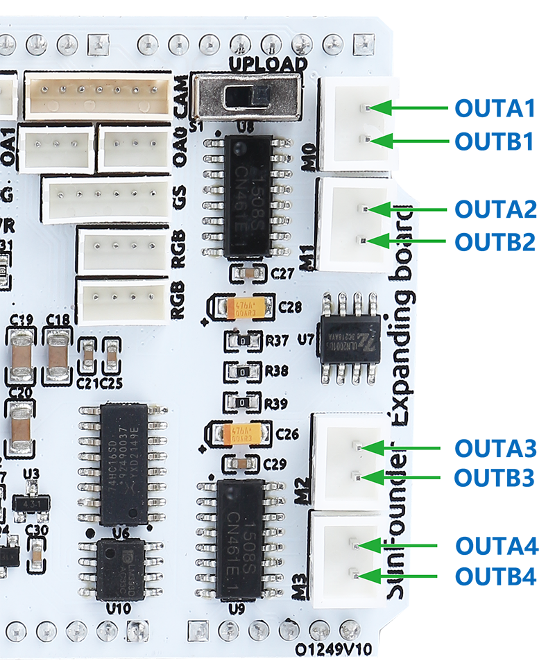

Motor Port
Here is the pinout of the 4 sets of motor ports.
These 4 sets of motors are driven by 2 TC1508S chips, which is a dual-channel motor driver chip with a maximum continuous output current of up to 1.8A/per channel.
