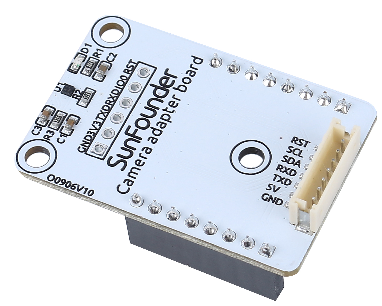

Camera Adapter Board
RST: Used to reset the ESP32-CAM.
SCL: Serial data pin for QMC6310
SDA: Serial clock pin of the QMC6310
RXD: The RXD of ESP32-CAM, you need to upload code to ESP32-CAM through these two serial pins, RXD and TXD.
TXD: TXD of ESP32-CAM
5V: 5V DC Supply Input
GND: Ground Input
The Camera Adapter Board, as the name implies, is an expansion board for the ESP-32 CAM, used to expand the ESP32-CAM so that it can be secured to the robot, and can be easily wired.

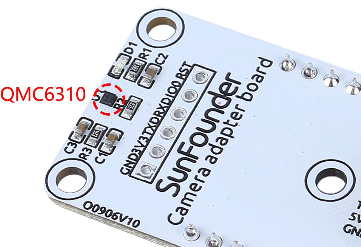

Also because the geomagnetic chip QMC6310 is susceptible to interference from motors, we put it on this camera adapter board to keep it as far away from the motors as possible.
Features
Working voltage: 5V
Interface Model: ZH1.5, 7P
Dimension: 40mm x 27mm x 15mm
Communication protocol: UART and I2C

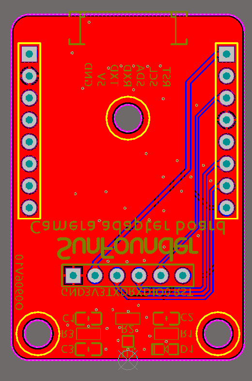

PCB

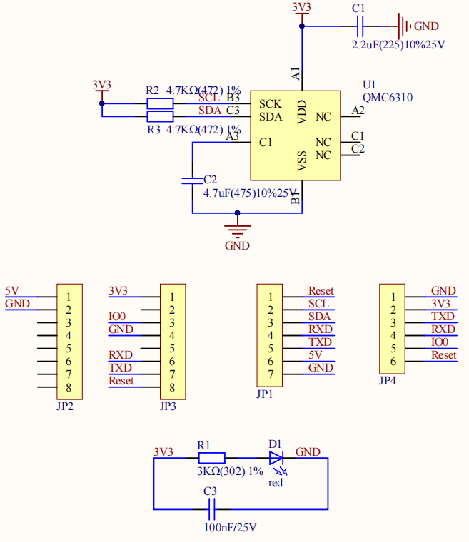

Schematic
About QMC6310
The QMC6310 is a three-axis magnetic sensor, which integrates magnetic sensors and signal condition ASIC into one silicon chip. This Land Grid Array package (LGA) is targeted for applications such as e-compass, map rotation, gaming and personal navigation in mobile and wearable devices.
The QMC6310 is based on state-of-the-art, high resolution, magneto-resistive technology. Along with the custom-designed 16-bit ADC ASIC, it offers the advantages of low noise, high accuracy, low power consumption, offset cancellation and temperature compensations. QMC6310 enables 1° to 2° compass heading accuracy. The I²C serial bus allows for easy interface.
The QMC6310 is in a 1.2x1.2x0.53mm3 surface mount 8-pin LGA package.
