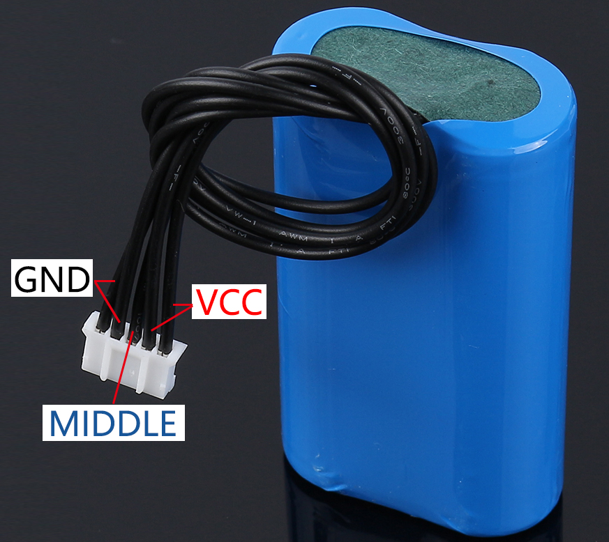

18650 Battery
../_images/2battery.jpg
  • VCC: Battery positive terminal, here there are two sets of VCC and GND is to increase the current and reduce the resistance.
  • Middle: To balance the voltage between the two cells and thus protect the battery.
  • GND: Negative battery terminal.
This is a custom battery pack made by SunFounder consisting of two 18650 batteries with a capacity of 2200mAh. The connector is PH2.0-5P, which can be charged directly after being inserted into the Zeus Car shield.
Pins Out
Features
  • Battery charge: 5V/2A
  • Battery output: 5V/5A
  • Battery capacity: 3.7V 2000mAh x 2
  • Battery life: 90min
  • Battery charge time: 130min
  • Connector: PH2.0, 5P
