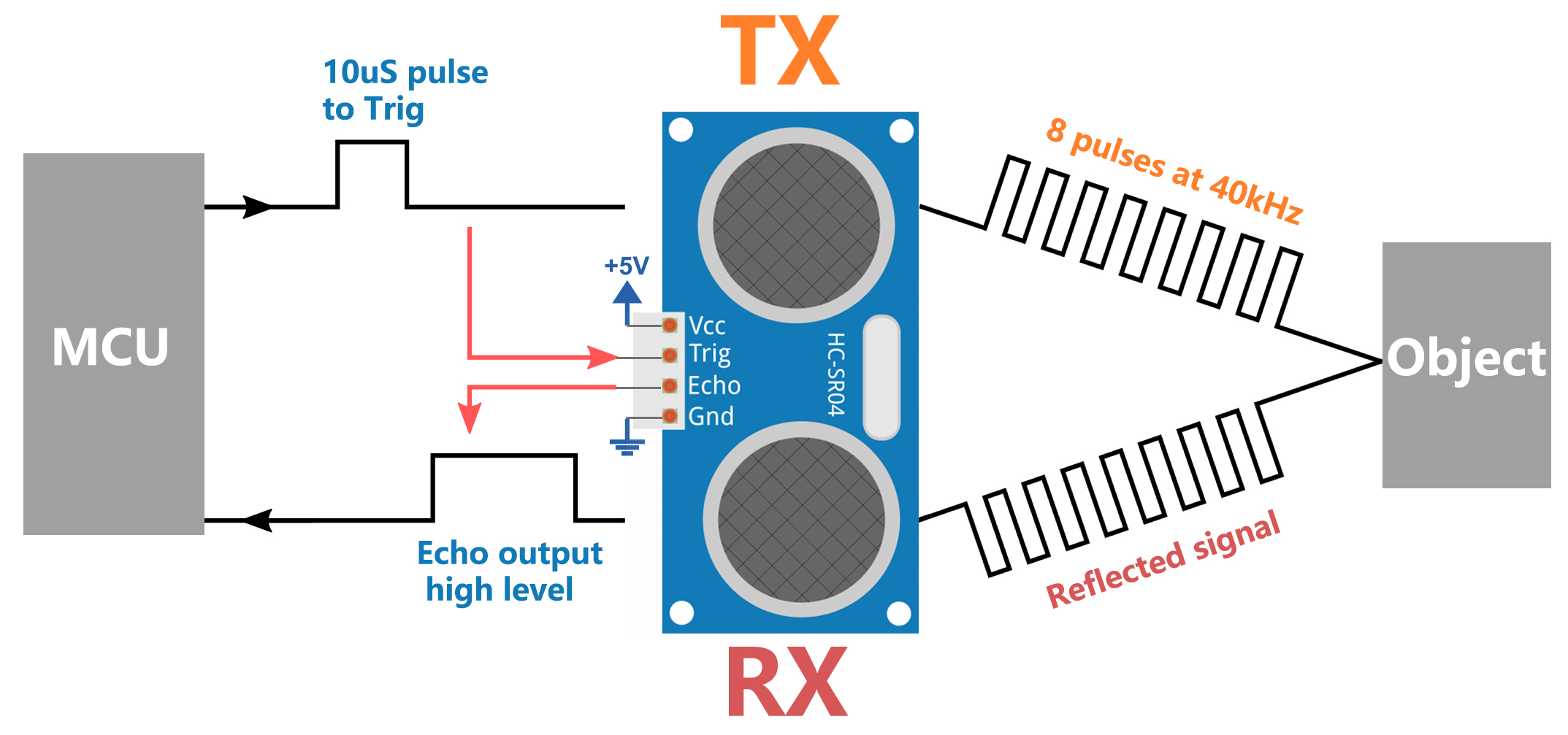

Principle
The basic principles are as follows:
  • Using IO trigger for at least 10us high level signal.
  • The module sends an 8 cycle burst of ultrasound at 40 kHz and detects whether a pulse signal is received.
  • Echo will output a high level if a signal is returned; the duration of the high level is the time from emission to return.
  • Distance = (high level time x velocity of sound (340M/S)) / 2
Formula:
  • us / 58 = centimeters distance
  • us / 148 = inch distance
  • distance = high level time x velocity (340M/S) / 2
