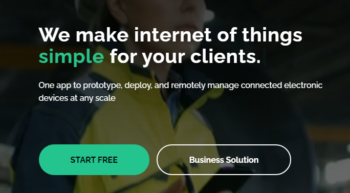

  1. Go to the BLYNK and click START FREE.

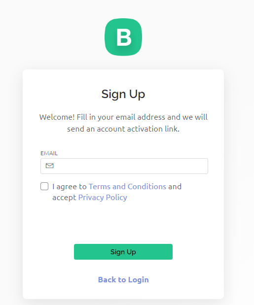

  2. Fill in your email address to register an account.

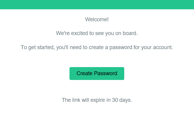

  3. Go to your email address to complete your account registration.

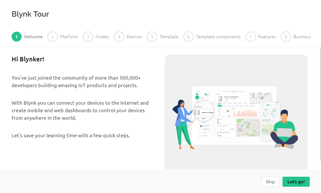

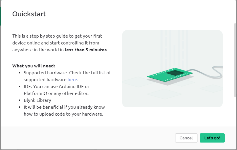

  4. Afterwards, Blynk Tour will appear and you can read it to learn the basic information about the Blynk.
    ../../_images/sp220607_143244.png

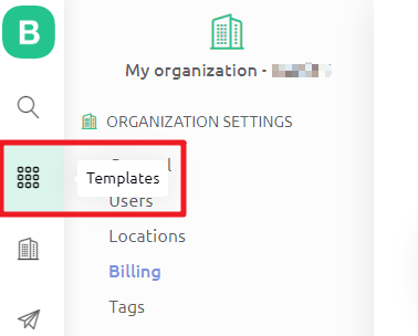

  6. Go to Template from the navigation bar.

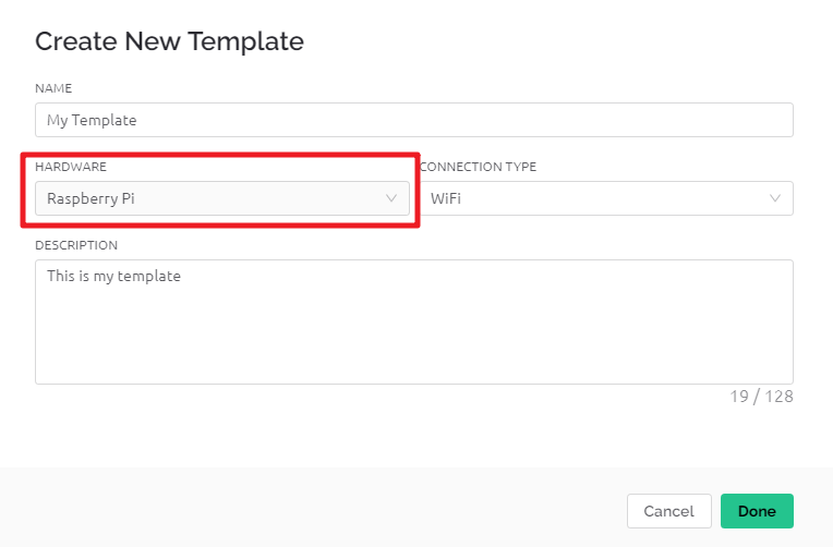

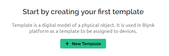

  7. Create New Template
    ../../_images/sp220913_170206.png
  8. Fill in NAME, feel free to do so; HARDWARE should be Raspberry Pi. Then Done.
    ../../_images/sp220913_170402.png
  9. You will be redirected to the Info page, just click on save in the top right corner.

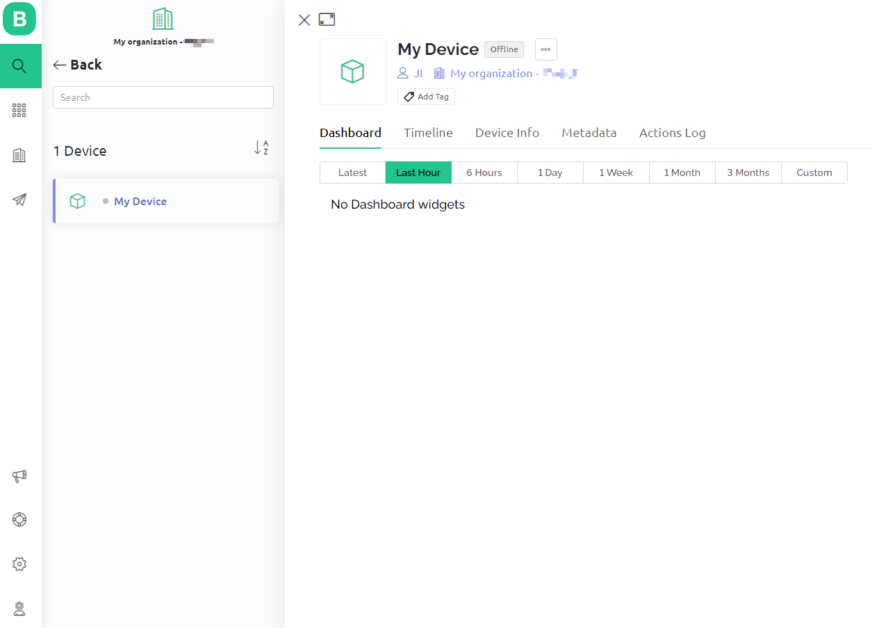

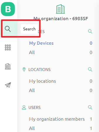

  10. Go to Search page from the navigation bar.
    ../../_images/sp220913_172727.png

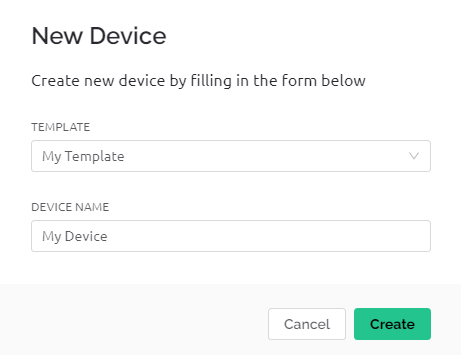

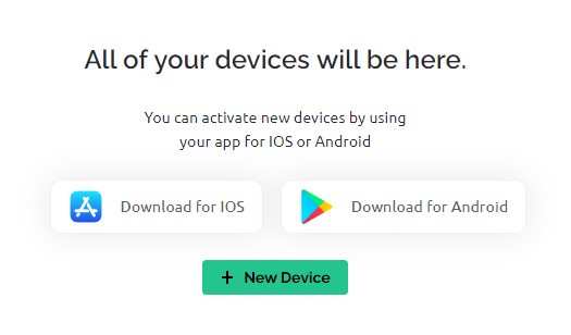

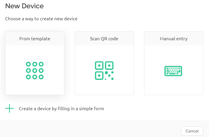

  11. Create New Device.
    ../../_images/sp220913_173259.png
  12. From template.
    ../../_images/sp220913_173350.png
  13. Select TEMPLATE as the one you just set, DEVICE NAME can be customized. Then click Create.
    ../../_images/sp220913_173507.png
  14. You should now see a page like this one, which means that your initial Blynk setup is complete.
    ../../_images/sp220913_173950.png

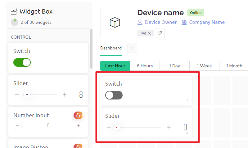

  2. Then drag any CONTROL Widgets you want onto the Dashboard. I dragged a Switch and a Slider.
    ../../_images/sp220913_180725.png

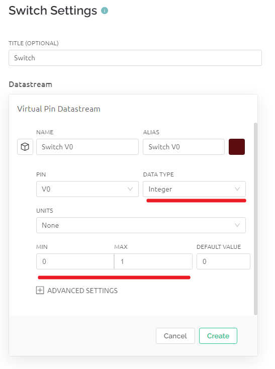

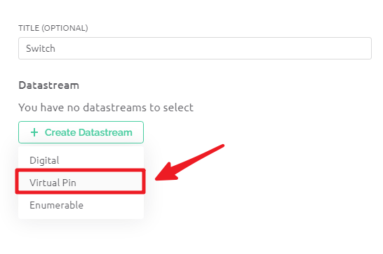

  4. Create Datastream, select Virtual Pin。
    ../../_images/sp220913_180906.png
  5. Complete the datastream setup. Here is the datastream created for Switch, so DATA TYPE select Interger, MIN and MAX set to 0 and 1. Create and then Save.
    ../../_images/sp220913_181113.png

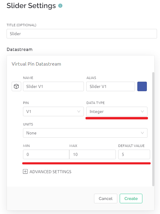

  6. Use the same steps to create a Datastream for the slider widget, and again, modify DATA TYPE, MIN and MAX to what you need.

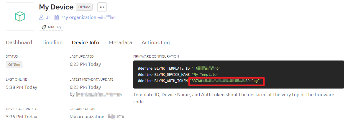

  1. Go to Blynk’s Device Info page, you will see some information under FIRMWARE CONFIGURATION, you need to copy BLYNK_AUTH_TOKEN down.
    ../../_images/sp220913_182456.png

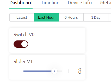

  1. Go to Blynk, and operate the widget on Dashboard.
    ../../_images/sp220913_183529.png
  2. Now you will be able to see your actions on the terminal.
