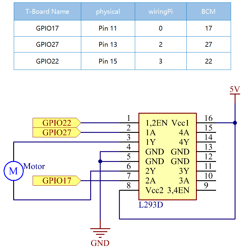

Schema Elettrico
../_images/1.3.1_motor_schematic.png
