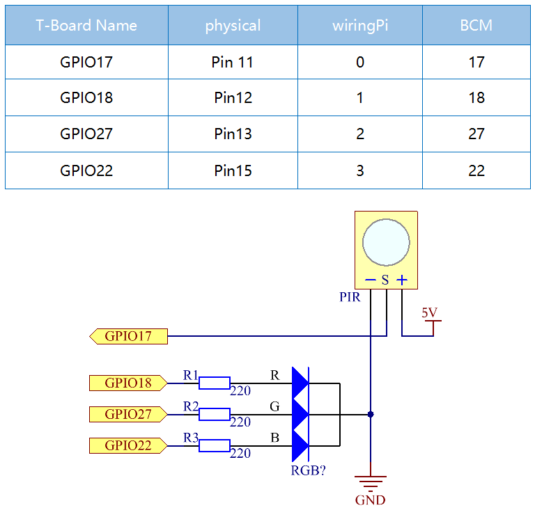

Schematic Diagram
../_images/image327.png

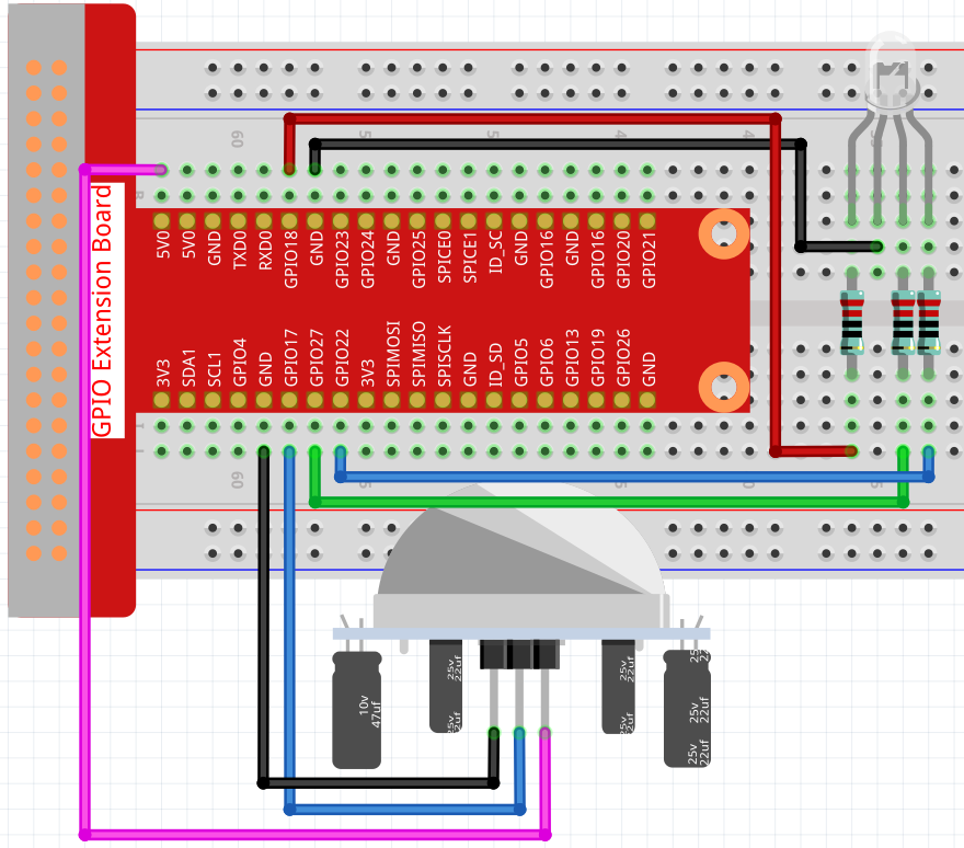

Experimental Procedures
../_images/image214.png

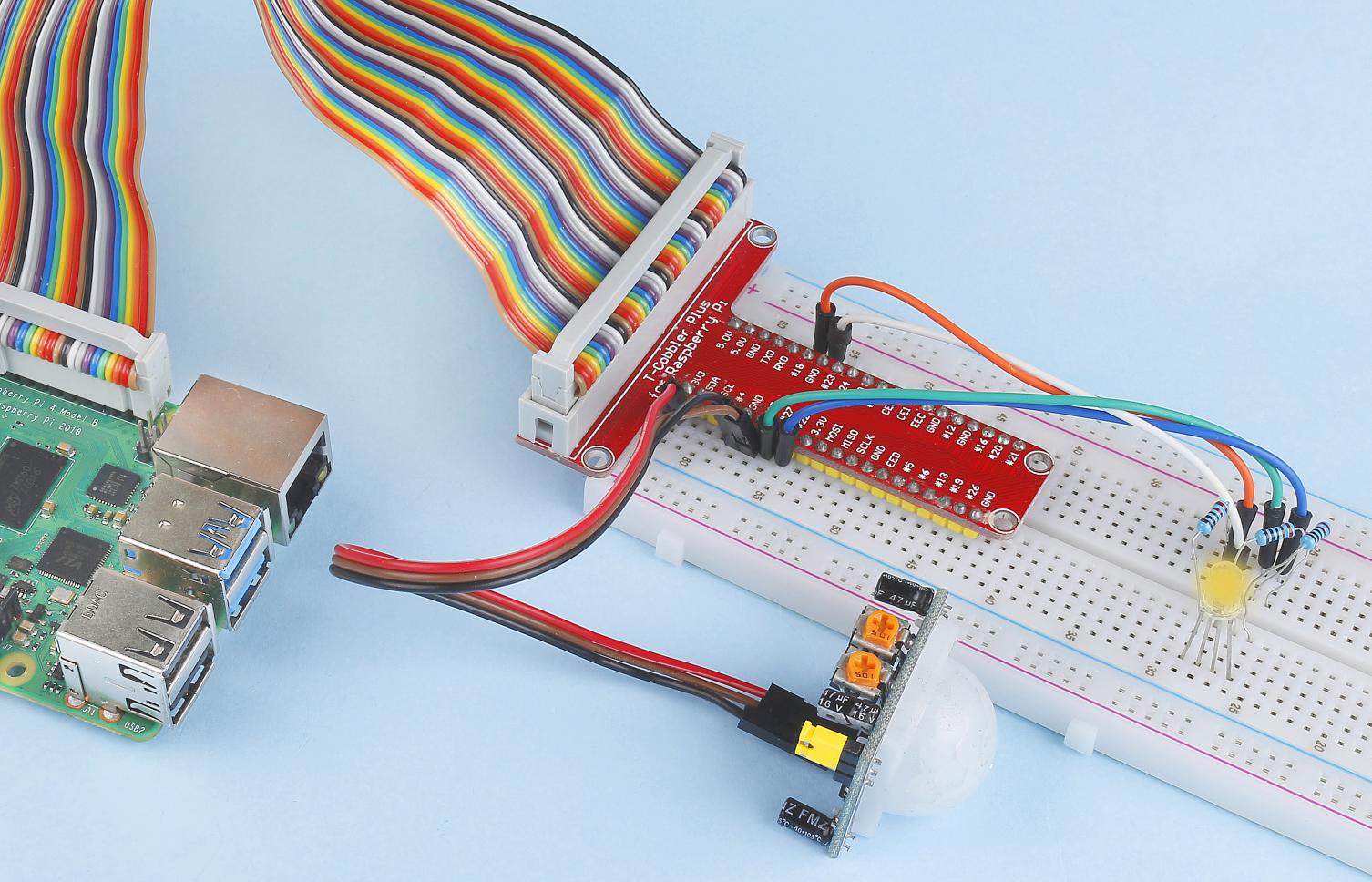

Photo du Phénomène
../_images/image215.jpeg
