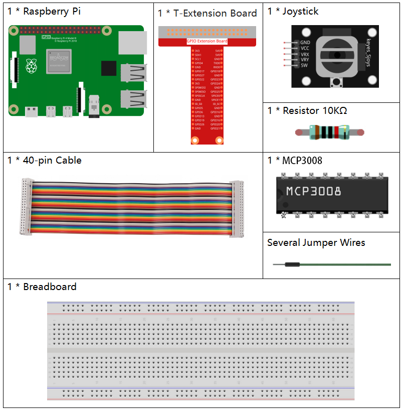

Required Components
../_images/image317-copy.png
ITEMS IN THIS KIT
COMPONENT INTRODUCTION
PURCHASE LINK
GPIO Extension Board
BUY
BUY
Jumper Wires
BUY
Resistor
BUY
Joystick Module
MCP3008
