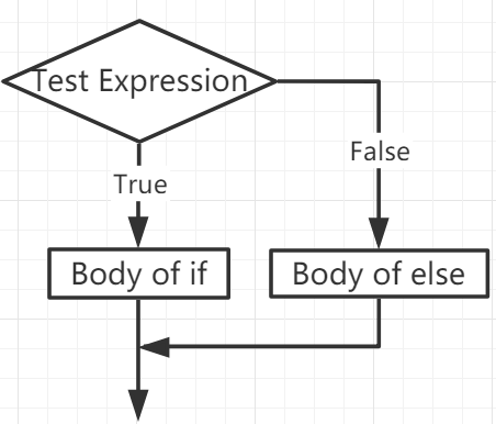

if...elseステートメントのフローチャート
../../../_images/if_else.png
num = -8
if num > 0:
    print(num, "is a positive number.")
else:
    print(num, "is a negative number.")
>>> %Run -c $EDITOR_CONTENT
-8 is a negative number.
