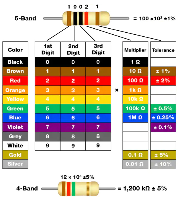

When using a resistor, we need to know its resistance first. Here are two methods: you can observe the bands on the resistor, or use a multimeter to measure the resistance. You are recommended to use the first method as it is more convenient and faster.
../../_images/resistance_card.jpg
As shown in the card, each color stands for a number.
Black
Brown
Red
Orange
Yellow
Green
Blue
Violet
Grey
White
Gold
Silver
0
7
8
9
0.1
0.01
The 4- and 5-band resistors are frequently used, on which there are 4 and 5 chromatic bands.
Normally, when you get a resistor, you may find it hard to decide which end to start for reading the color. The tip is that the gap between the 4th and 5th band will be comparatively larger.
Therefore, you can observe the gap between the two chromatic bands at one end of the resistor; if it’s larger than any other band gaps, then you can read from the opposite side.

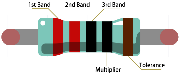

Let’s see how to read the resistance value of a 5-band resistor as shown below.
../../_images/220ohm.jpg
So for this resistor, the resistance should be read from left to right. The value should be in this format: 1st Band 2nd Band 3rd Band x 10^Multiplier (Ω) and the permissible error is ±Tolerance%. So the resistance value of this resistor is 2(red) 2(red) 0(black) x 10^0(black) Ω = 220 Ω, and the permissible error is ± 1% (brown).
