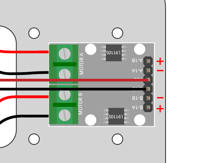

Forward
Now let’s connect the input of L9110 module directly to 12V and GND respectively to make the car move.
  1. Connect R3 board, L9110 module and 2 motors.
../_images/car_1.png
  1. Connect B-1B(B-2A) and A-1A to VCC, and B-1A and A-1B to GND, then you will be able to see the car moving forward.
../_images/1.move_4.png
If not both turn forward, but the following situations occur, you need to readjust the wiring of the two motors.
  • If both motors turn backward at the same time (left motor turns clockwise, right motor turns counterclockwise), swap the wiring of the left and right motors at the same time, OA(A) and OB(A) swap, OA(B) and OB(B) swap.
  • If the left motor turns backward (clockwise rotation), exchange the wiring of OA(B) and OB(B) of the left motor.
  • If the right motor turns backward (counterclockwise rotation), swap the wiring of OA(A) and OB(A) of the right motor.
