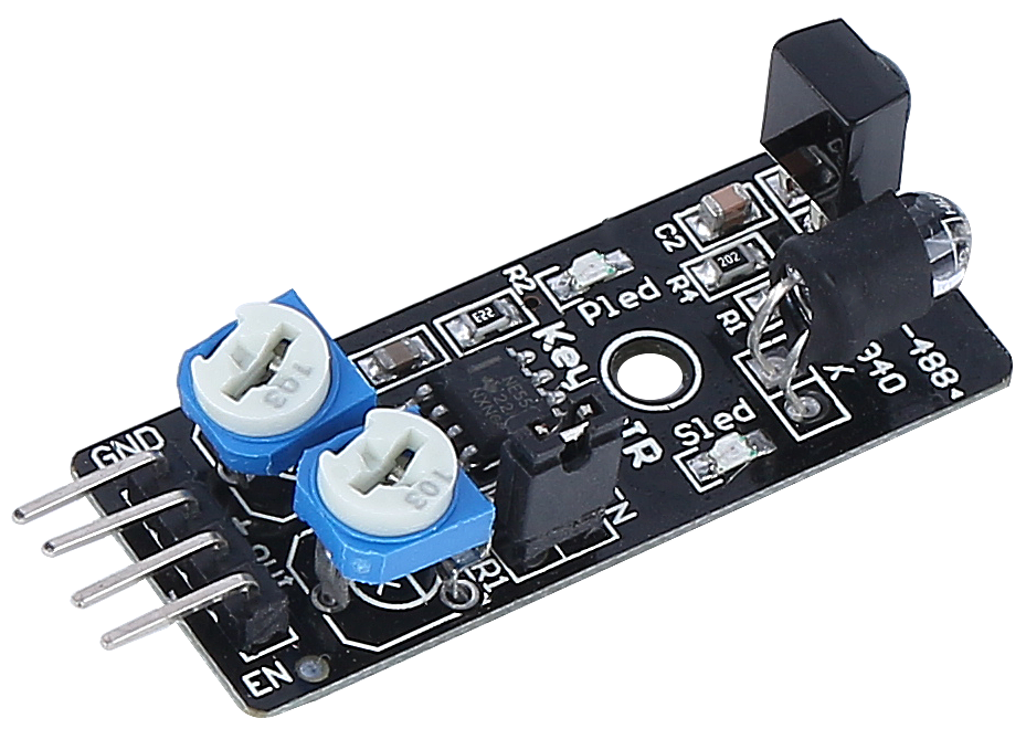

About IR Obstacle Avoidcance Module
../_images/ir_avoid.png
This is a common IR obstacle avoidance module that uses a pair of IR transmitting and receiving components. Basically, the transmitter emits infrared light, and when the detection direction encounters an obstacle, the infrared light is back and received by the receiver tube. At this time, the indicator lights up. After circuit processing, it outputs a low level signal.
Sensing distance 2-40cm, with excellent anti-interference ability. There are different reflectivity levels in different colors of objects, so the darker the object, the closer to black the detection distance is short. The 2-30cm range of this sensor is detected against a white wall.
Reading Detection Values
  1. Before use, you need to adjust the detection distance of the two obstacle avoidance modules to 15CM, the steps are as follows
    • Start by adjusting the right obstacle avoidance module. During transportation, collisions may cause the transmitter and receiver on the infrared module to tilt. Therefore, you need to manually straighten them.
    • Place an obstacle about 15cm away from the IR obstacle avoidance module.
    • On the module are two potentiometers, one to adjust the sending power and one to adjust the sending frequency. By adjusting these two potentiometers, you can adjust the detection distance.
    • Then you can adjust a potentiometer, and if at 15cm, the signal light on the module illuminates, the adjustment is successful; if it doesn’t, adjust another potentiometer.

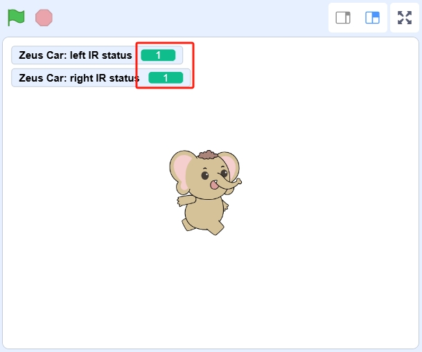

  2. The values will now be displayed on the stage.
    ../_images/8_code_ir_status.png
  3. Move your hand close to the infrared obstacle avoidance modules to trigger detection and observe the value changes on the stage.
    • If the IR modules detect an obstacle, the value will be 1.
    • If no obstacle is detected, the value will be 0.

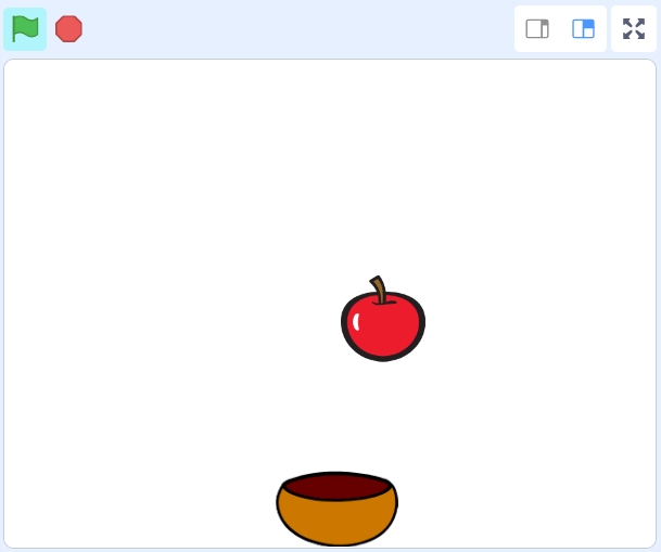

Catch the Apple Game
Next, we’ll use the Zeus Car’s two infrared obstacle avoidance modules to play a “Catch the Apple” game.
  • Choose an Apple sprite that will continuously fall from the top of the stage.
  • Select a Bowl sprite, and use the Zeus Car’s two infrared modules to control its left and right movement to catch the apples.
  • When the Bowl sprite catches an apple, the apple will reappear at the top.
  • If the Bowl sprite misses the apple, the game ends.
    ../_images/8_code_apple.png

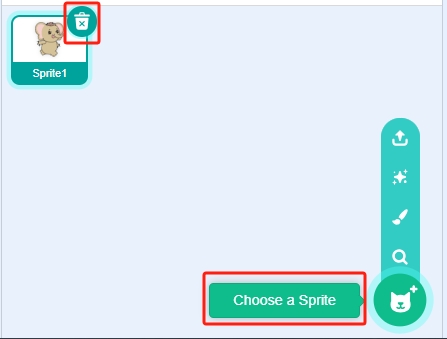

1. Add the Bowl Sprite and Write Scripts
  1. Delete the default sprite and click on “Choose a Sprite” to add a new one.

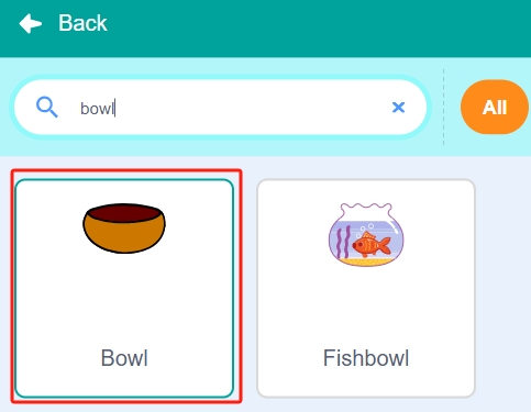

    ../_images/7_code_picture_choose.png
  2. Choose the Bowl sprite.

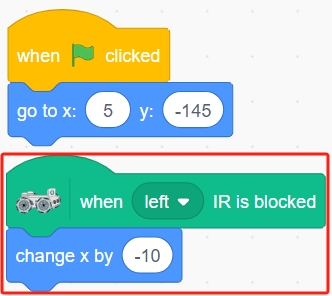

  4. When the green flag is clicked, have the Bowl sprite go to the starting position.
    ../_images/8_code_bowl_click.png

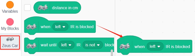

  5. From the Zeus Car category, drag out the “when (left) IR is blocked” block.
    ../_images/8_code_bowl_left.png

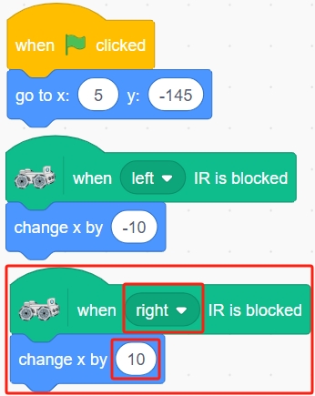

  6. When the left IR sensor is blocked, decrease the Bowl sprite’s x position by 10 to move it left.
    ../_images/8_code_bowl_x_decrease.png
  7. Similarly, when the right IR sensor is blocked, increase the Bowl sprite’s x position by 10 to move it right.
    ../_images/8_code_bowl_x_increase.png

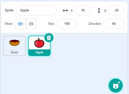

2. Add the Apple Sprite and Write Scripts
  1. Click “Choose a Sprite” and select the Apple sprite.
    ../_images/8_code_apple_choose.png

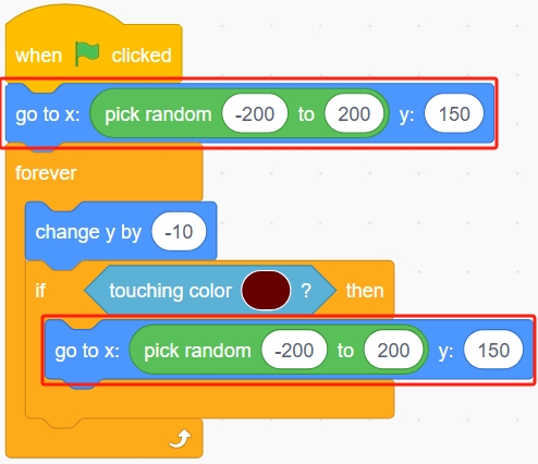

  2. When the green flag is clicked, have the Apple sprite go to a position at the top of the stage.
    ../_images/8_code_apple_up.png

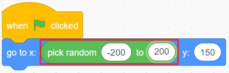

  3. Use the “pick random (1) to (10)” block from the Operators category to set the x position of the Apple sprite to a random value between -200 and 200. This allows the apple to appear at a random position along the top of the stage.
    ../_images/8_code_apple_random.png

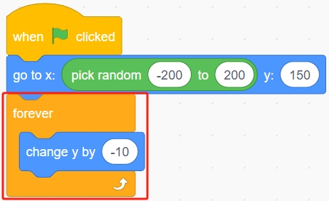

  4. Change the y position of the Apple sprite to make it fall down the stage. If it falls too quickly, you can decrease the value from 10 to a smaller number.
    ../_images/8_code_apple_y.png

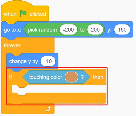

  5. Use an “if then” block and the “touching color ()” block to detect when the Apple sprite is caught by the Bowl sprite.
    ../_images/8_code_apple_touch_color.png
  1. Set the catching condition:
    • We will set it so that when the Apple sprite touches the dark brown color of the Bowl sprite, it means the apple has been caught.
    • Use the eyedropper tool to select the exact color from the Bowl sprite.
    ../_images/8_code_apple_touch.png
  2. If the apple is caught, have the Apple sprite return to the top at a random x position.
    ../_images/8_code_apple_back.png

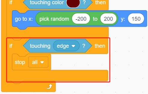

  3. If the Apple sprite touches the edge (meaning it was not caught), stop the script to end the game.
    ../_images/8_code_apple_edge.png

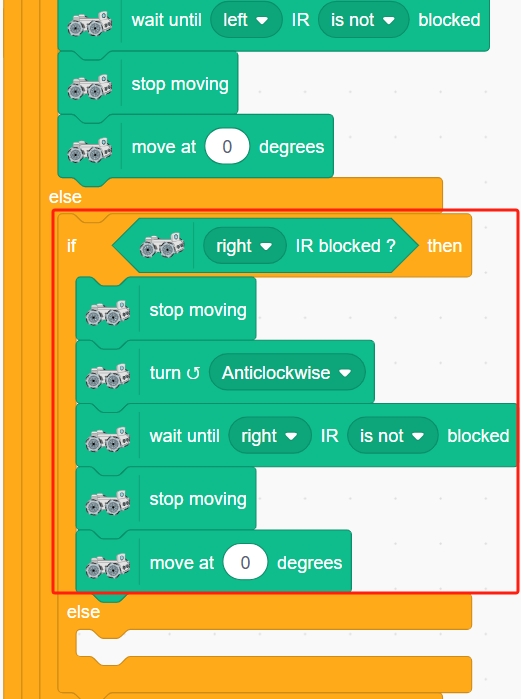

    • If right IR sensor detects an obstacle:
      • Stop moving.
      • Turn counterclockwise (left) until the right sensor no longer detects an obstacle.
      • Stop turning.
      • Resume moving forward.
      ../_images/8_code_avoid_right_ir.png

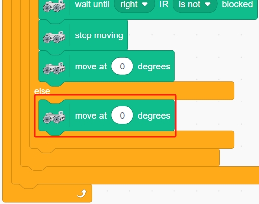

    • If no obstacles are detected:
      • Continue moving forward.
      ../_images/8_code_avoid_else.png

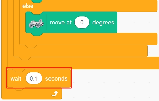

  4. Include a short wait time at the end of the forever loop to prevent the script from running too fast, which can cause issues with sensor readings and command processing.
    ../_images/8_code_avoid_wait.png
