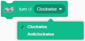

1. “turn (Clockwise) (1) secs” Block
  • This block allows the Zeus Car to turn clockwise or counterclockwise for a specified number of seconds.
    ../_images/3_code_turn.png
  • Drag the “turn (Clockwise) (1) secs” block from the Zeus Car category into the script area.
    ../_images/3_code_turn_drag.png
  • Click the block, and you will see the Zeus Car turn clockwise for 1 second and then stop.

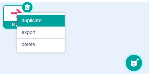

  1. Long-press the Right Arrow sprite and select Duplicate to create a copy. This also copies its scripts.
    ../_images/3_code_arrow_copy.png

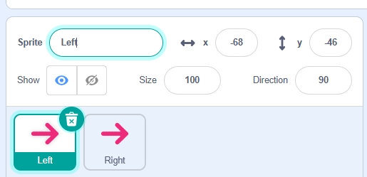

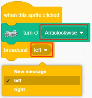

  2. Rename the duplicated sprite to Left, and adjust its position.
    ../_images/3_code_arrow_left.png
  3. Select the Left Arrow sprite, then go to the Costumes tab. Set its costume to arrow1-b.
    ../_images/3_code_arrow_cos_b.png
  4. Modify the script so that when the Left Arrow sprite is clicked, the Zeus Car turns counterclockwise and broadcasts the “left” message.
    ../_images/3_code_arrow_left_message.png

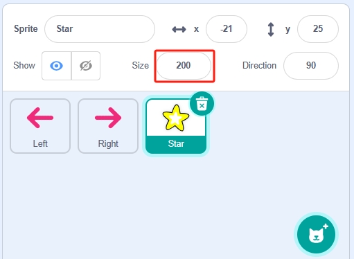

  1. Choose the Star sprite from the library and increase its size.
    ../_images/3_code_star_choose.png

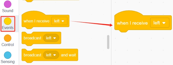

  1. Handle Broadcast Messages:
    • Drag the “when I receive (left)” block from the Events category into the script area.
      ../_images/3_code_star_receive.png
    • When the Star sprite receives the “left” message, it will also rotate counterclockwise.

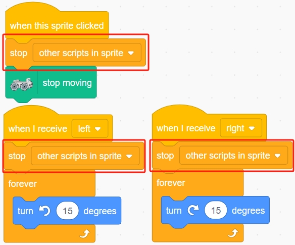

  2. Add the “stop (other scripts in sprite)” block to each action to prevent interference between different scripts.
    ../_images/3_code_start_stop_other.png

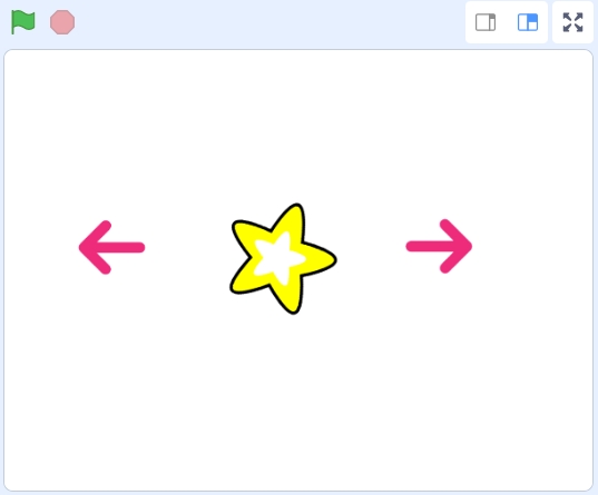

  3. Adjust the sprites’ positions on the stage. If the Zeus Car is successfully connected to the app, you will observe the following setup:
    • When you click the Left sprite, both the Zeus Car and the Star sprite turn counterclockwise simultaneously.
    • When you click the Right sprite, both the Zeus Car and the Star sprite turn clockwise simultaneously.
    • When you click the Star sprite, both the Zeus Car and the Star sprite stop turning.
    ../_images/3_code_star_arrow.png
