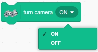

Turn On the Camera:
  • Drag the “turn camera ON” block from the Zeus Car category.
  • Click it, and you’ll see the background of the stage display the camera’s feed.
../_images/5_code_camera_on.png

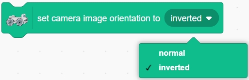

Correct the Camera Orientation:
  • If you see the camera feed inverted, use the “set camera image orientation to (normal)” block to correct it.
  • You can choose between normal and inverted orientations.
../_images/5_code_camera_inverted.png

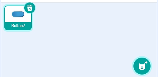

  1. Delete the default sprite to start fresh. Click on “Choose a Sprite” and select “Button2”.
    ../_images/5_code_move_button2.png

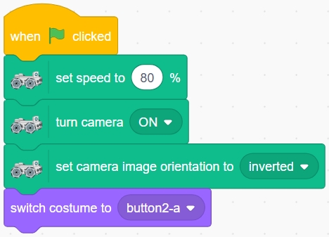

  2. When the green flag is clicked:
    • Set the Zeus Car’s movement speed to 80%.
    • Turn on the camera using the “turn camera ON” block.
    • If the camera feed is inverted, use the “set camera image orientation to (inverted)” block to correct it.
    • Set the initial costume of Button2 to “button2-a”.
    ../_images/5_code_move_buttona.png

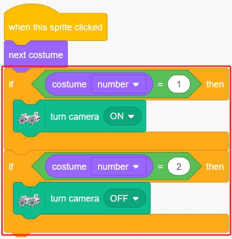

  3. When the Button2 sprite is clicked, it will switch costumes between “button2-a” and “button2-b”.
    ../_images/5_code_camera_switch.png
  4. Use an “if…else” block to check the “costume number”.
    • If the “costume number” is 1 (which corresponds to “button2-a”), turn the camera ON.
    • If the “costume number” is 2 (which corresponds to “button2-b”), turn the camera OFF.
    ../_images/5_code_move_turn_off.png
