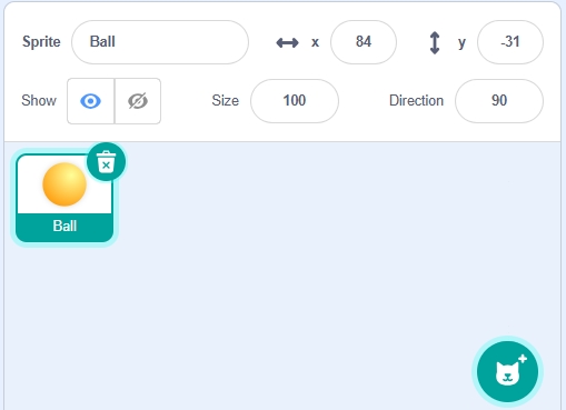

1. Add and Modify the Ball Sprite
  1. Delete the default sprite and select the Ball sprite.
    ../_images/10_code_ball_choose.png

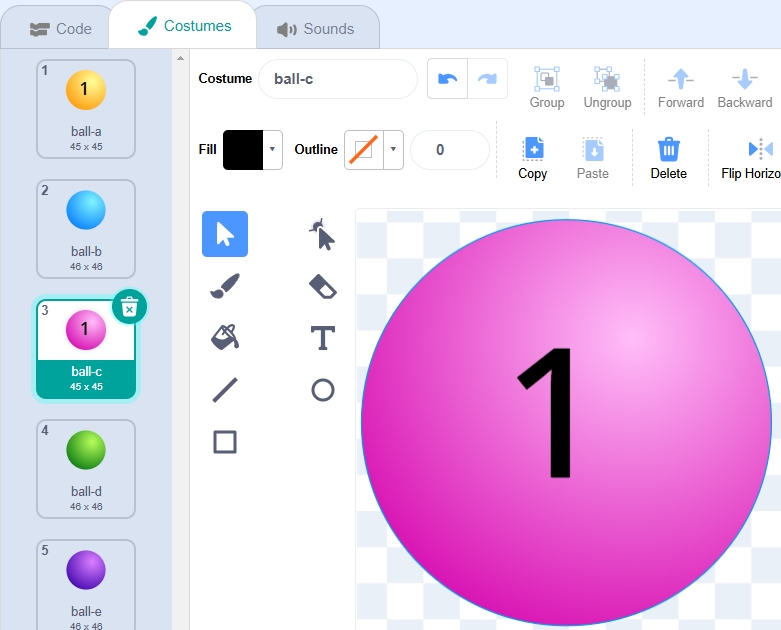

  2. Go to the Costumes tab for the Ball sprite:
    • select the ball-a costume and add a number “1” using the Text Tool with any color except yellow.
      ../_images/10_code_ball_number.png
    • Modify the ball-c costume in the same way.
      ../_images/10_code_ball_c.png

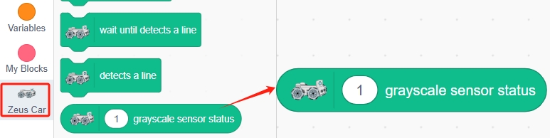

  2. Drag the “(1) grayscale sensor status” block from the Zeus Car category to monitor a specific sensor’s status. This block outputs:
    • 1 when the sensor detects a black line.
    • 0 when it detects a white surface.
    ../_images/10_code_ball_status.png
