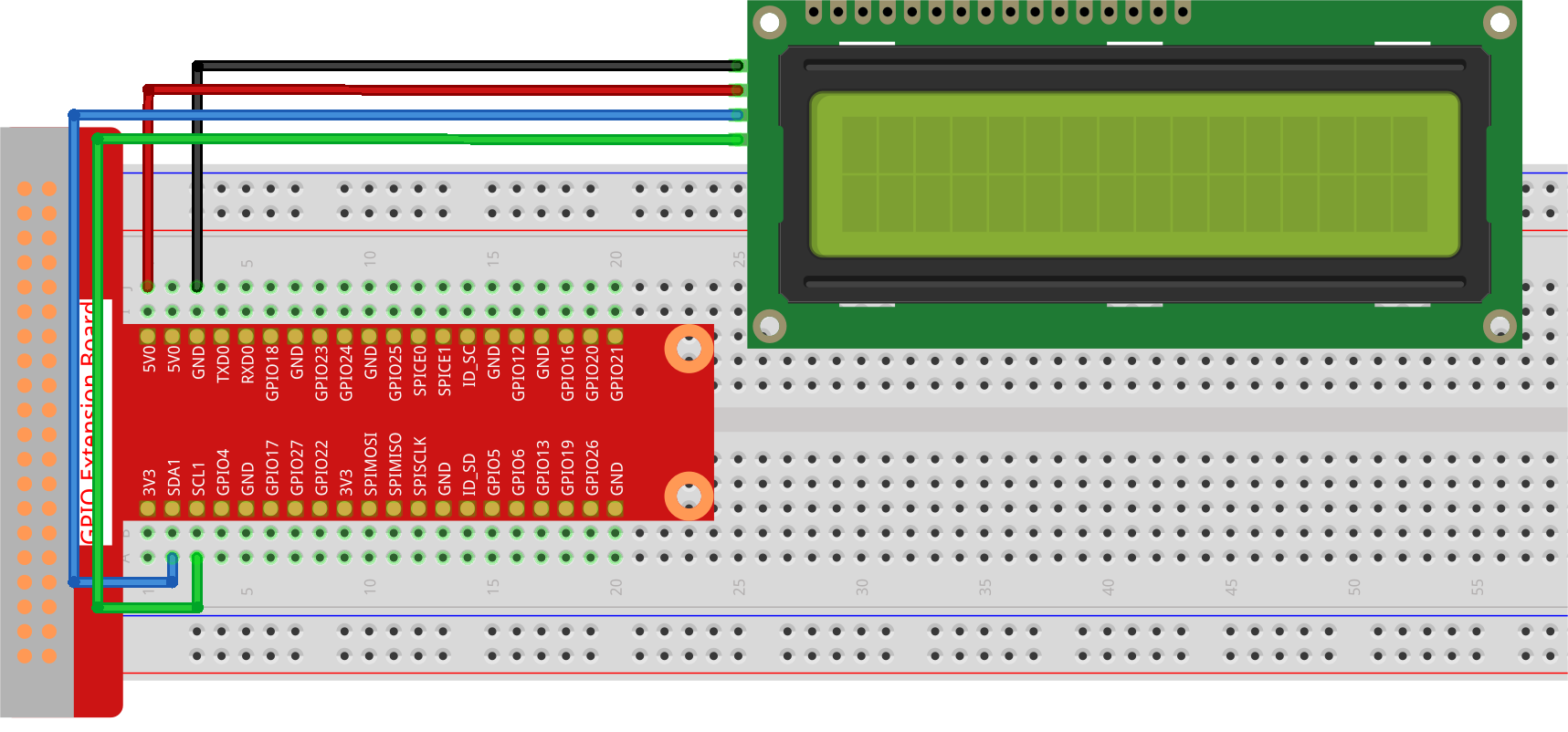

Schema Elettrico
SDA1
Pin 3
SCL1
Pin 5
../_images/1.1.7_i2c_lcd_schematic.png
Procedure Sperimentali
../_images/1.1.7_i2c_lcd1602_circuit.png
