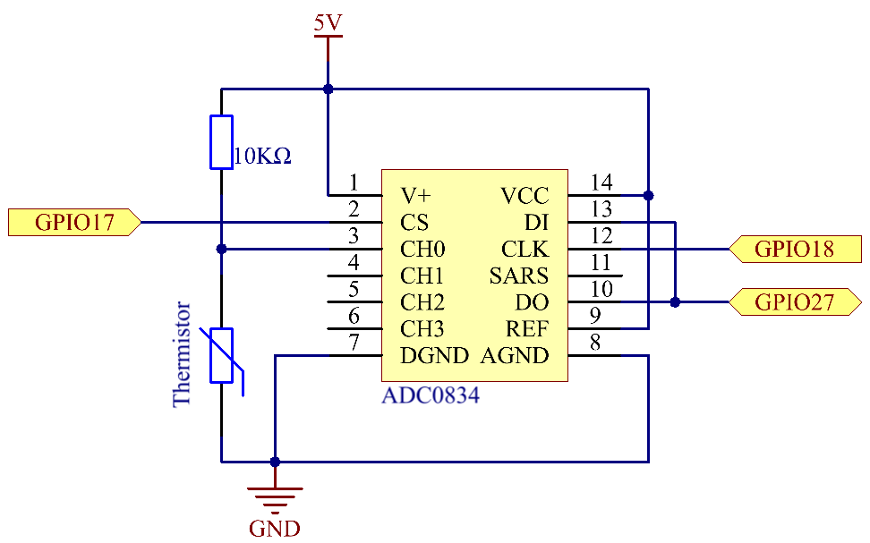

Schema Elettrico
../_images/image323.png ../_images/image324.png

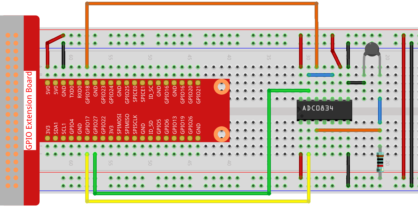

Procedure Sperimentali
../_images/image202.png
