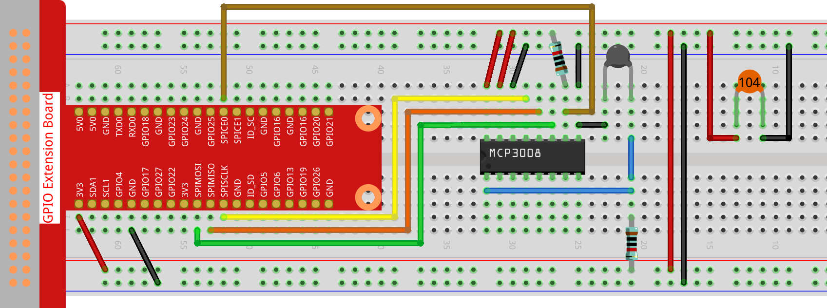

Experimental Procedures
Step 1: Build the circuit.
../_images/2.2.2_Thermistor_bb.png
