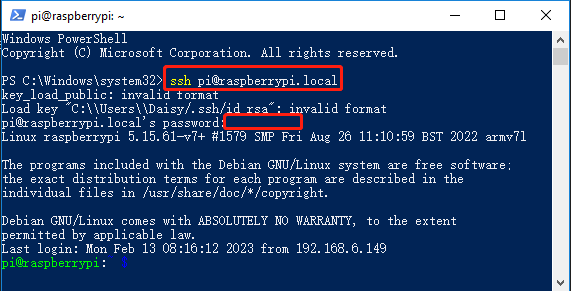

  6. Close PowerShell, reopen it (no need to run as administrator this time), and use the ssh command to log in:
    ../../_images/powershell_login.png
