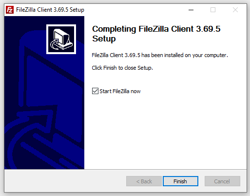

  1. Visit the FileZilla official website and download FileZilla Client for your operating system.
  2. Install and launch the program.

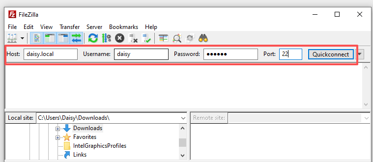

  3. Open FileZilla and enter the following information:
    • Host: <hostname>.local or the Raspberry Pi’s IP address
    • Username: your Pi username
    • Password: the password set in Raspberry Pi Imager
    • Port: 22 (for SFTP)
    • Click Quickconnect (or press Enter) to establish a connection.

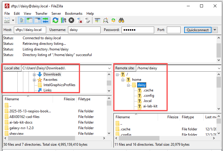

  4. Once connected, the left panel shows your local files, and the right panel shows the Raspberry Pi files.
    ../../_images/filezilla_in.png
  5. You can:
    • Upload a file: drag from the left panel → right panel
    • Download a file: drag from the right panel → left panel
    FileZilla will immediately start the transfer, and the status will appear in the panel at the bottom.
