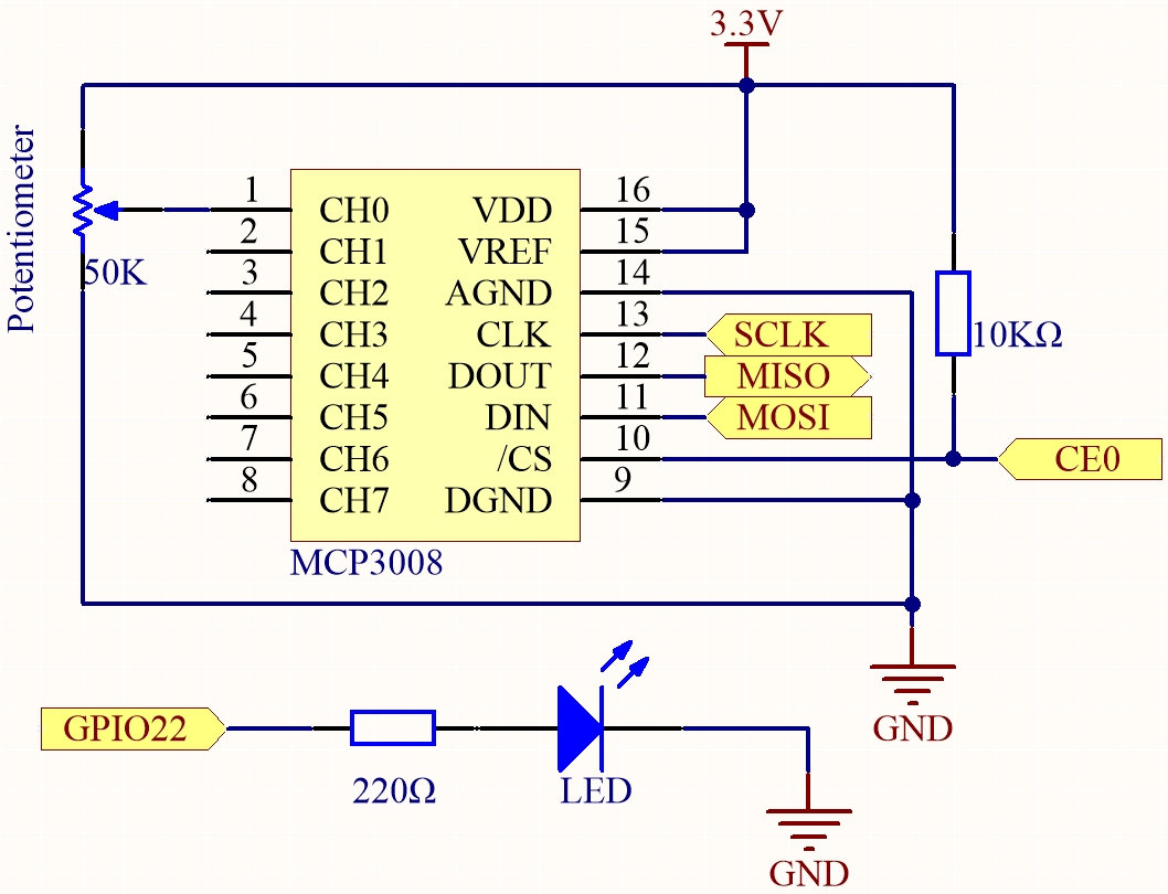

Schematic Diagram๏ƒ
T-Board Name
physical
WiringPi
SPICE0
pin24
10
8
SPIMOSI
pin19
12
10
SPIMISO
pin21
13
9
SPISCLK
pin23
14
11
GPIO22
pin15
22
../_images/schematic_2.1.7_potentiometer_mcp30081.png
