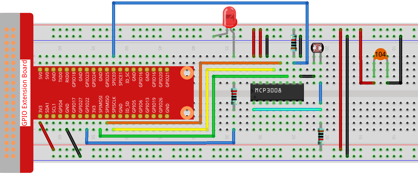

Experimental Procedures
Step 1: Build the circuit.
../_images/2.2.1_Photoresistor_bb.png
cd ~/raphael-kit/nodejs/
Step 3: Run the code.
sudo node photoresistor-2.js
