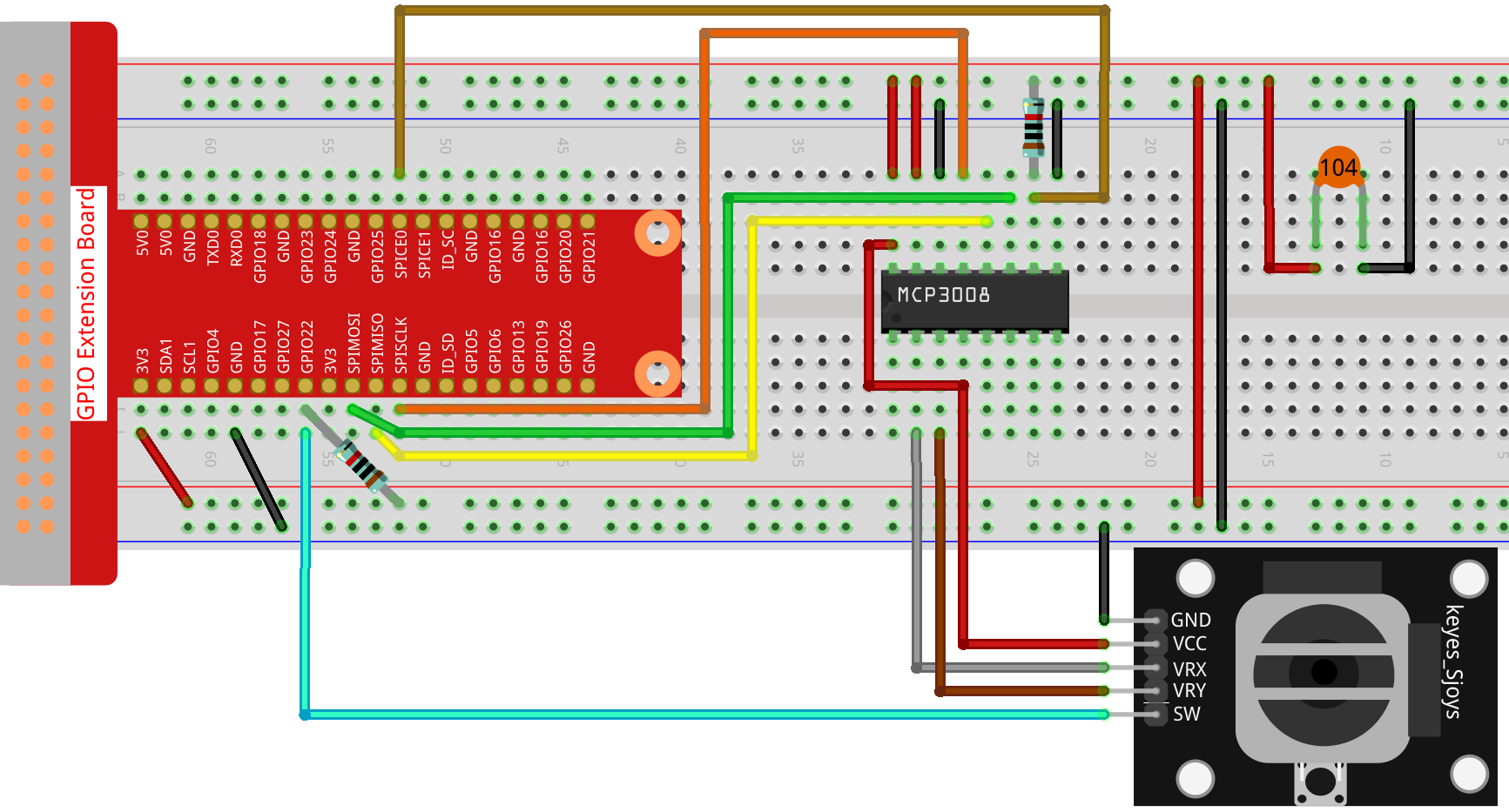

Schematic Diagram
When the data of joystick is read, there are some differents between axis: data of X and Y axis is analog, which need to use MCP3008 to convert the analog value to digital value. Data of Z axis is digital, so you can directly use the GPIO to read, or you can also use ADC to read.
../_images/schematic_2.1.9_joystick_mcp3008_js.png
Experimental Procedures
Step 1: Build the circuit.
../_images/2.1.9_Joystick_js.png
