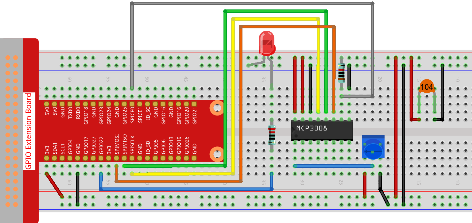

Step 1: Build the circuit.
../_images/2.1.7_Potentiometer_bb.png
Please place the chip by referring to the corresponding position depicted in the picture. Note that the grooves on the chip should be on the left when it is placed.
