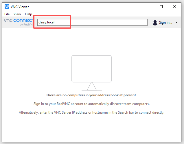

Open RealVNC Viewer, then enter your Raspberry Pi’s IP address or
<hostname>.localand press Enter.

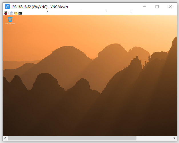

You should now see the Raspberry Pi desktop:
