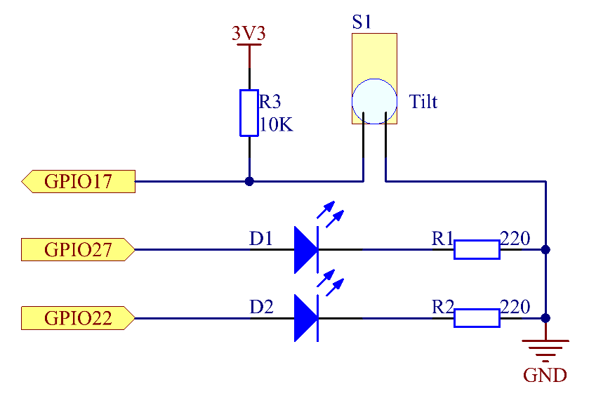

Schaltplan
../_images/2.1.5_tilt_switch_schematic_1.png ../_images/2.1.5_tilt_switch_schematic_2.png
