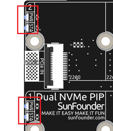

  4. Check the status of the NVMe PIP Module’s LEDs:
    After confirming all connections, power on the device and observe the two indicators on the NVMe PIP Module:
    • PWR LED: Should be lit.
    • STA LED: Should blink to indicate normal operation.
    ../_images/dual_nvme_pip_leds1.png
    • If the PWR LED is on but the STA LED is not blinking, it indicates the NVMe SSD is not recognized by the Raspberry Pi.

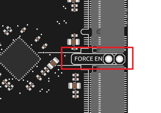

    • If the PWR LED is off, short the “Force Enable” pins on the module. If the PWR LED lights up, it could indicate a loose FPC cable or unsupported system configuration for NVMe.
    ../_images/dual_nvme_pip_j41.png
