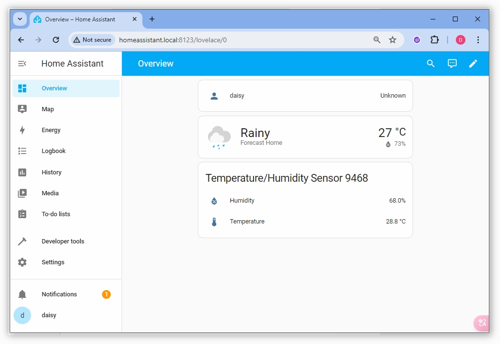

  • Follow the prompts to choose your location and other configurations. Once completed, you will enter the Home Assistant dashboard.
    ../../_images/home_dashboard1.png

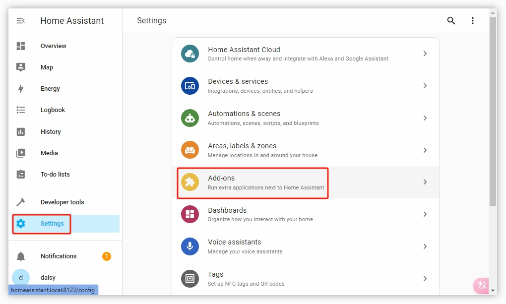

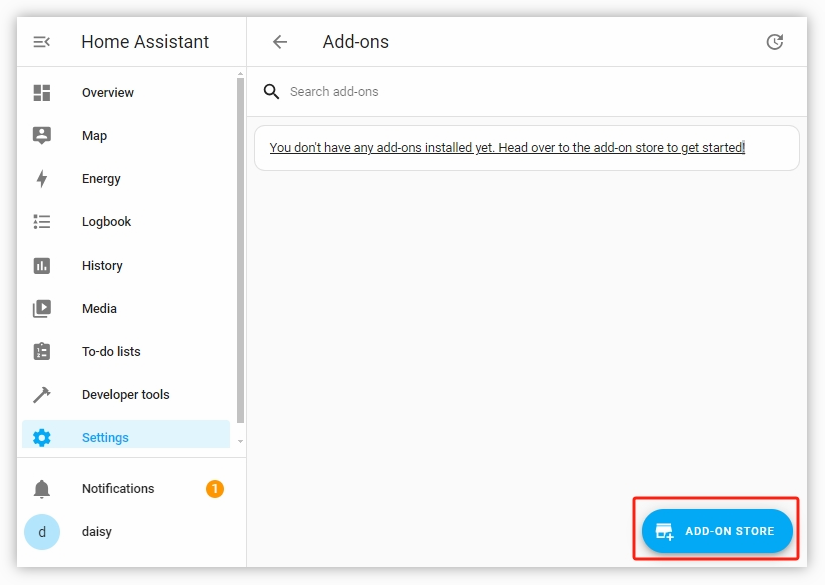

  1. Open Settings -> Add-ons.
    ../../_images/home_setting_addon1.png
  2. Click the plus sign in the bottom right corner to enter the add-on store.
    ../../_images/home_addon1.png

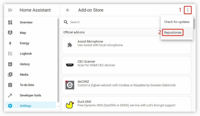

  3. In the add-on store, click the menu in the top right corner and select Repositories.

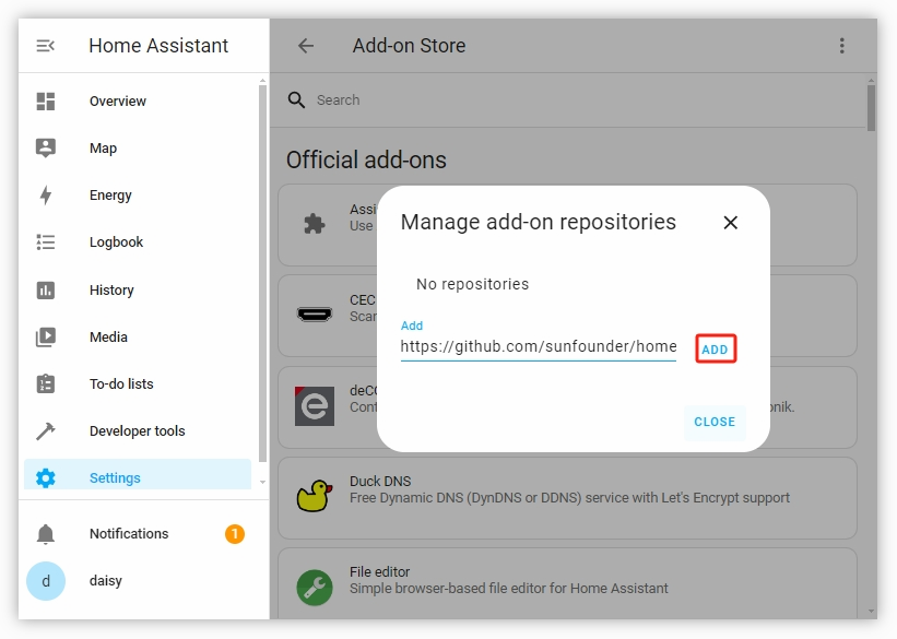

    ../../_images/home_add_res1.png
  4. Enter the SunFounder add-ons repository URL: https://github.com/sunfounder/home-assistant-addon, and click ADD.
    ../../_images/home_res_add1.png

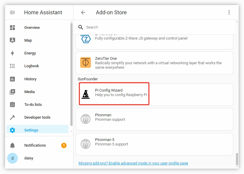

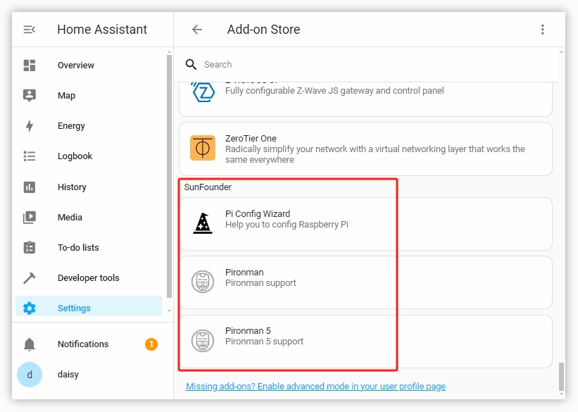

  5. After successfully adding, close the pop-up window and refresh the page. Find the SunFounder add-ons list.
    ../../_images/home_addon_list1.png

  1. Find Pi Config Wizard in the SunFounder add-ons list and click to enter.

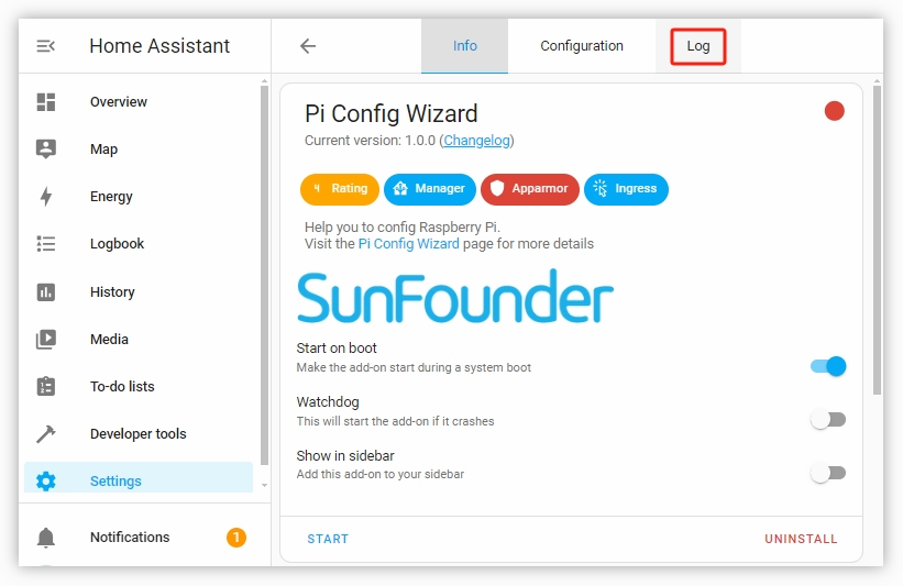

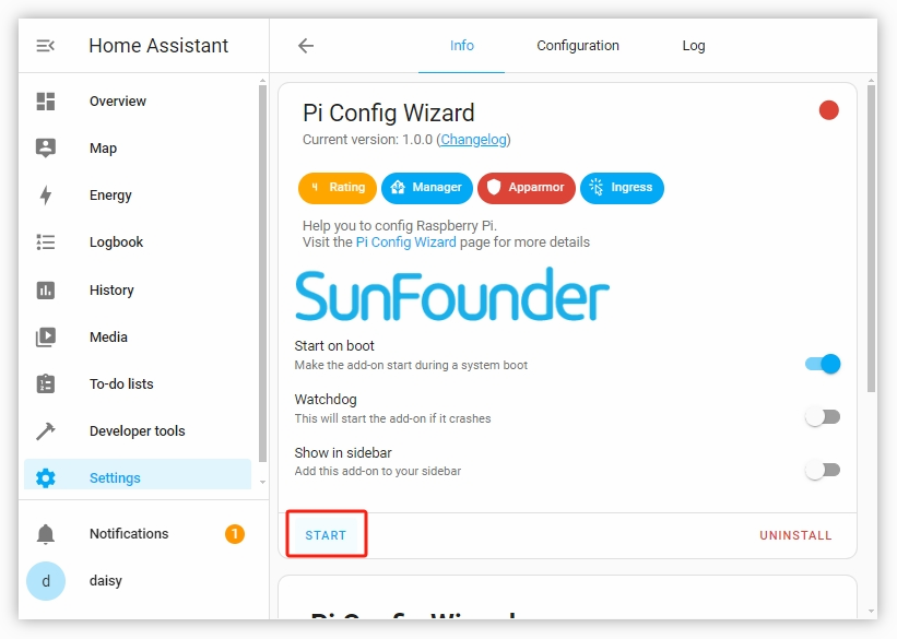

  3. After the installation is complete, switch to the Log page to confirm if there are any errors.
    ../../_images/home_log1.png

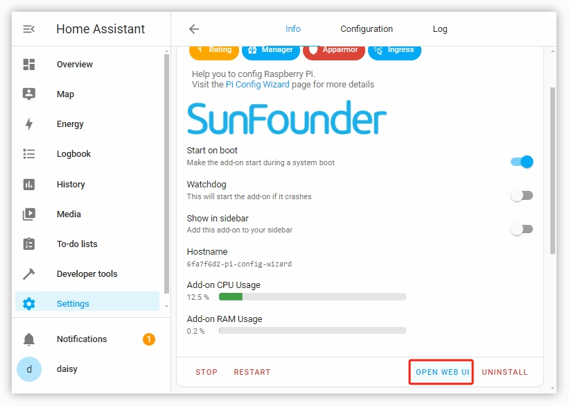

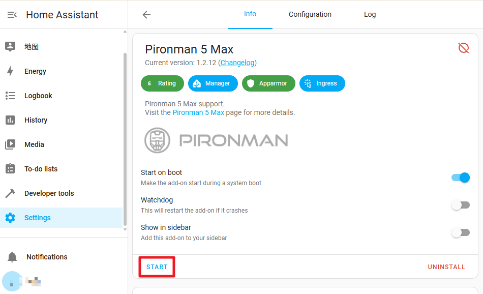

  4. If there are no errors, return to the Info page and click START to start this add-on.
    ../../_images/home_start1.png
  5. Now open the WEB UI.
    ../../_images/home_open_web_ui1.png

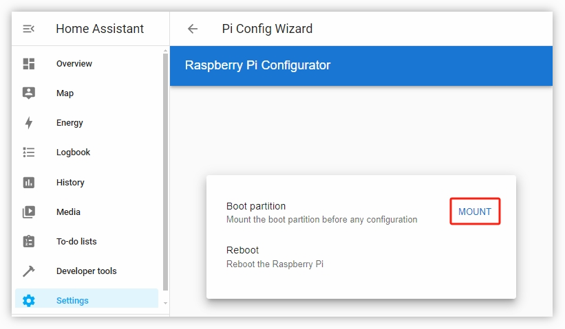

  6. In the Web UI, you will see an option to mount the Boot partition. Click MOUNT to mount the partition.
    ../../_images/home_mount_boot1.png

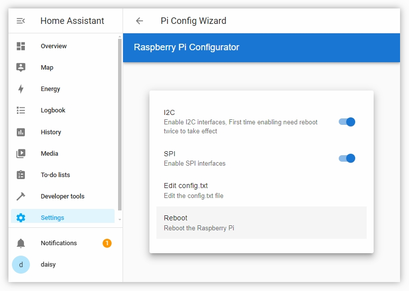

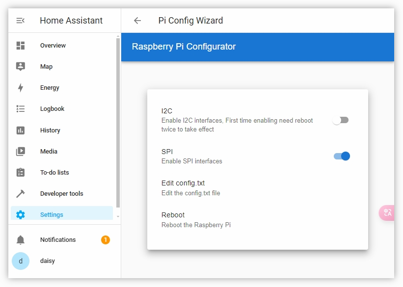

  7. After successful mounting, you will see options to set I2C, SPI, and edit the config.txt file. Check I2C and SPI to enable them. Once they show as enabled, click the reboot button at the bottom to restart the Raspberry Pi.
    ../../_images/home_i2c_spi1.png

  9. Usually, you will see that SPI is enabled, but I2C is not because I2C requires two reboots. Enable I2C again, then restart the Raspberry Pi.
    ../../_images/home_enable_i2c1.png
  10. After the reboot, return to the MOUNT page again. You will see that both I2C and SPI are enabled.
    ../../_images/home_i2c_spi_enable1.png

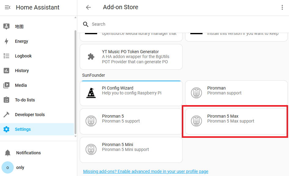

  3. Find Pironman 5 MAX in the SunFounder add-ons list and click to enter.
    ../../_images/home_pironman5_max_addon.png

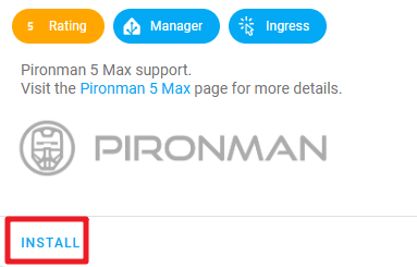

  4. Now install the Pironman 5 MAX add-on.
    ../../_images/home_pironman5_max_addon_install.png

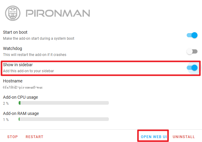

  6. Now you can click OPEN WEB UI to open the Pironman 5 MAX web page. You can also check the option to display the Web UI in the sidebar. This will allow you to see the Pironman 5 MAX option in the left sidebar of Home Assistant, and click to open the Pironman 5 MAX page.
    ../../_images/home_pironman5_max_webui.png
