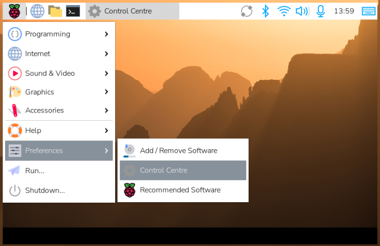

  1. Click Menu -> Preferences in the bottom-left corner of the screen, then find and open the Control Centre.
    ../../_images/sleep_screen1.png

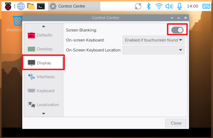

  2. In the Control Centre interface, click to enter the Display settings.
  3. Locate the Screen Blanking option and toggle it on.
../../_images/sleep_screen2.png

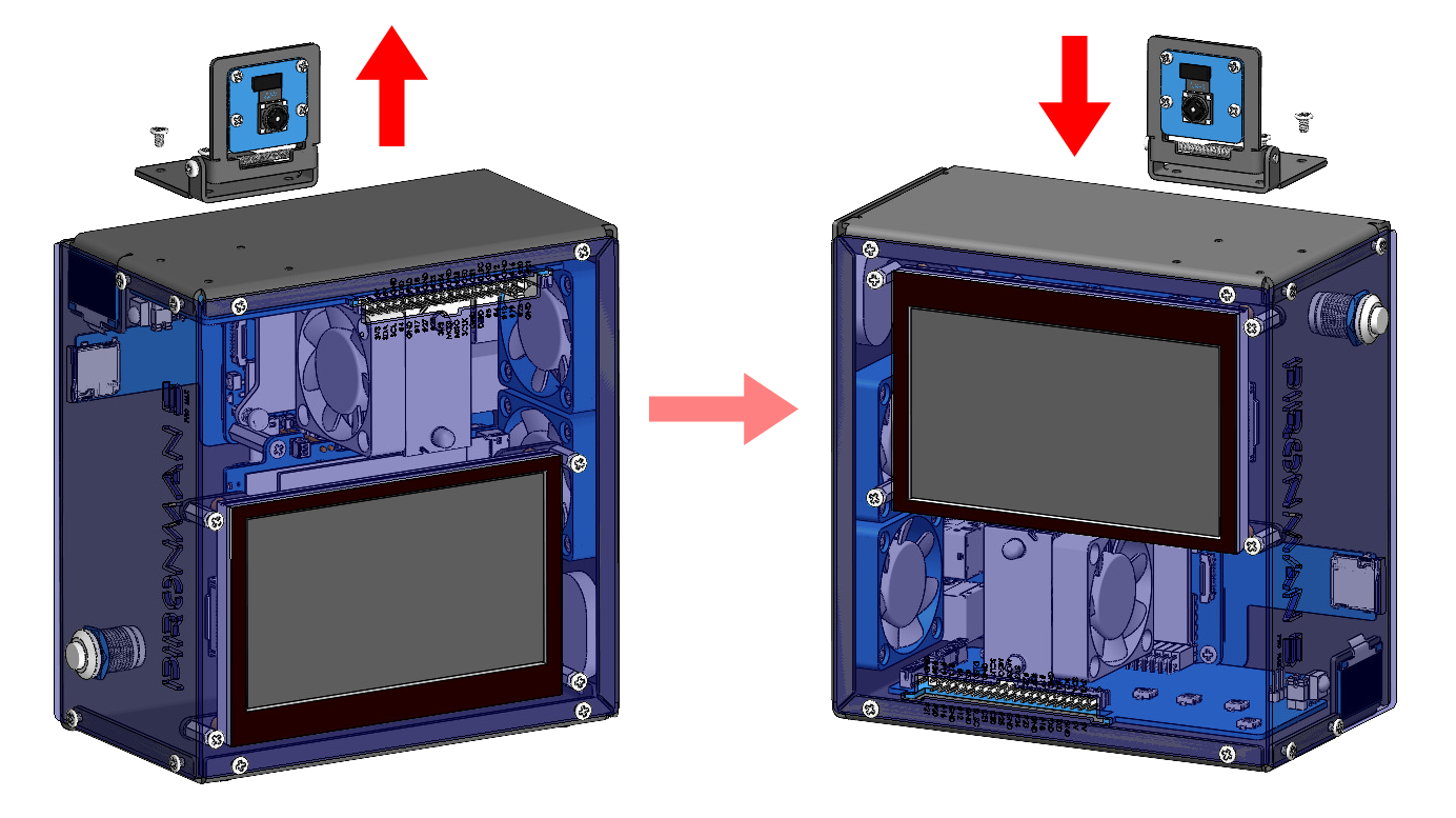

    Remove the camera from the Pironman 5 Pro MAX, flip the entire unit over, and reinstall the camera. The installation should be symmetrical to its original orientation.
    ../../_images/inverted_screen0.png

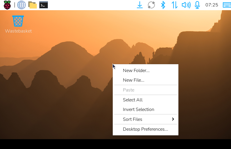

    Power on the device. On the touchscreen, long-press the desktop to bring up the menu and select Desktop Preferences.
    ../../_images/inverted_screen1.png

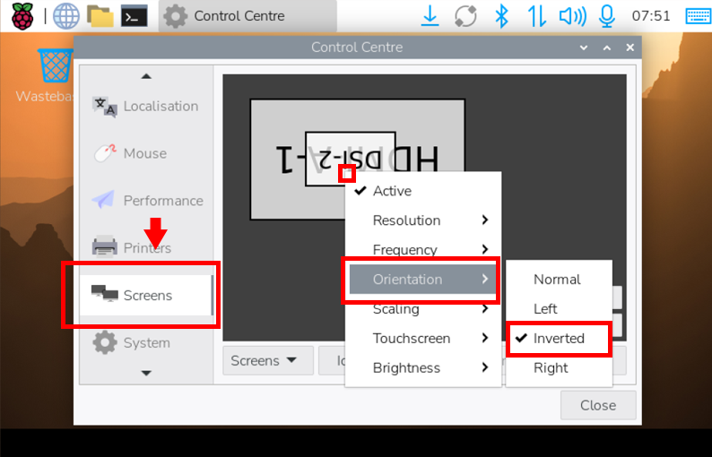

    Scroll down to find the Screens option, then long-press the screen indicator in the display. Select Orientation → Inverted.
    ../../_images/inverted_screen2.png

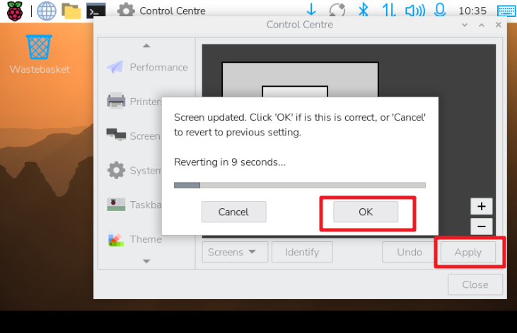

    Apply, the update window will show the screen, you need to click OK to confirm.
    ../../_images/inverted_screen3.png
