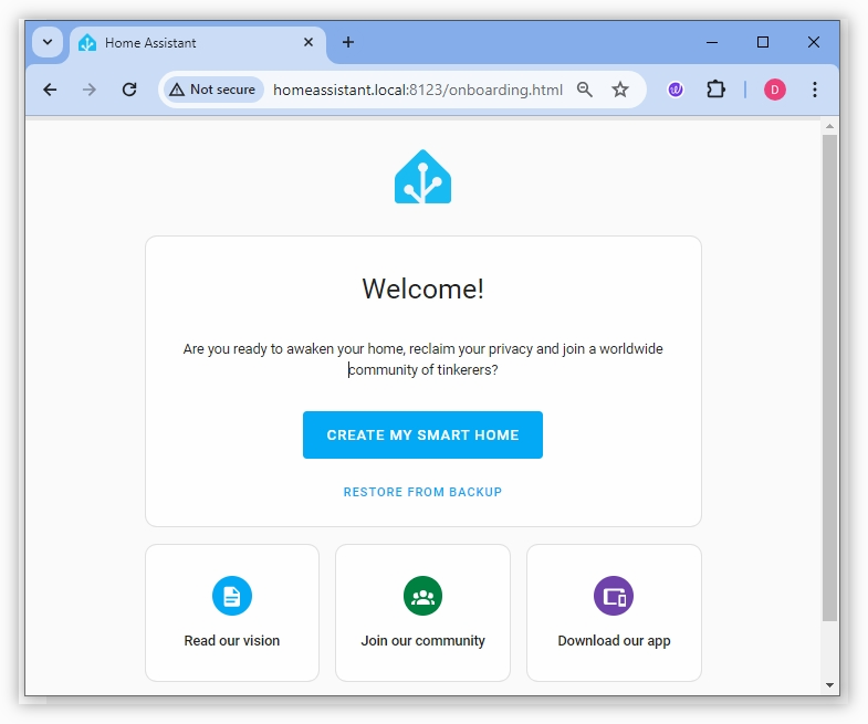

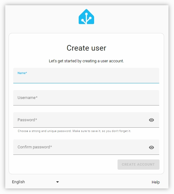

  • Select CREATE MY SMART HOME, and then create your account.
    ../../_images/home_account2.png

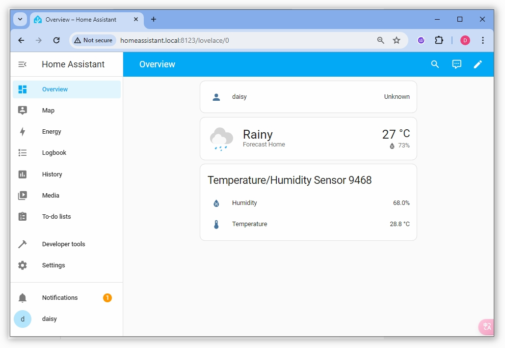

  • Follow the prompts to choose your location and other configurations. Once completed, you will enter the Home Assistant dashboard.
    ../../_images/home_dashboard2.png

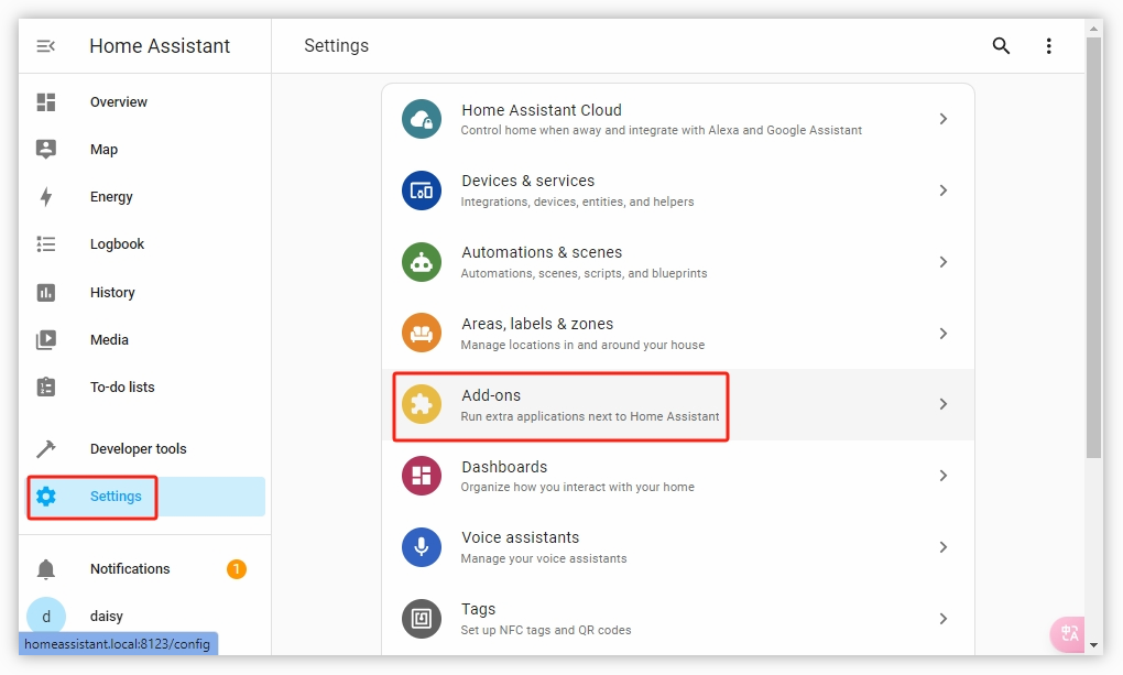

  1. Open Settings -> Add-ons.
    ../../_images/home_setting_addon2.png

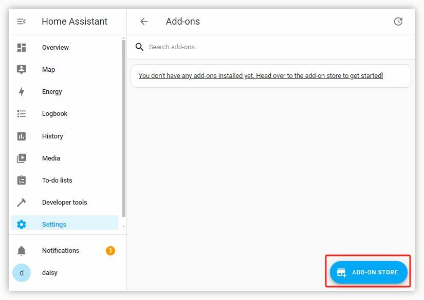

  2. Click the plus sign in the bottom right corner to enter the add-on store.

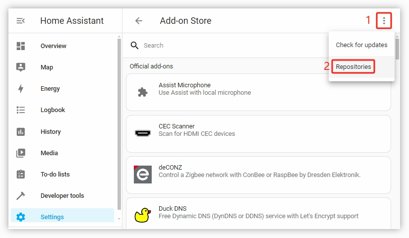

  3. In the add-on store, click the menu in the top right corner and select Repositories.
    ../../_images/home_add_res2.png

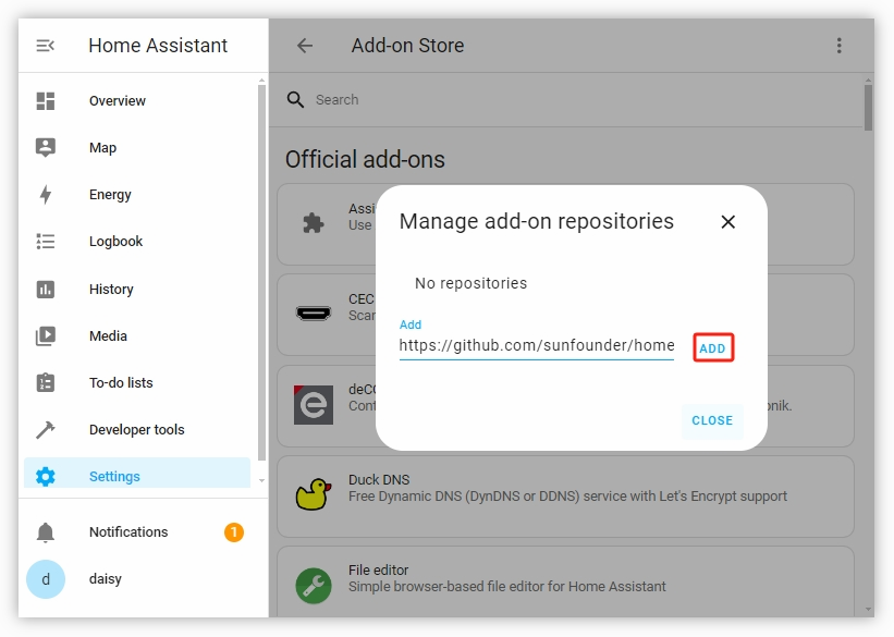

  4. Enter the SunFounder add-ons repository URL: https://github.com/sunfounder/home-assistant-addon, and click ADD.

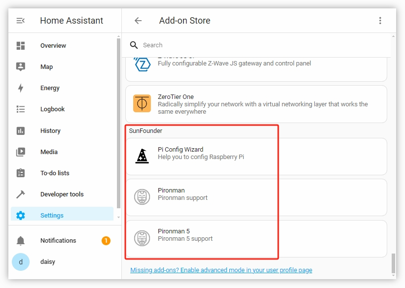

  5. After successfully adding, close the pop-up window and refresh the page. Find the SunFounder add-ons list.

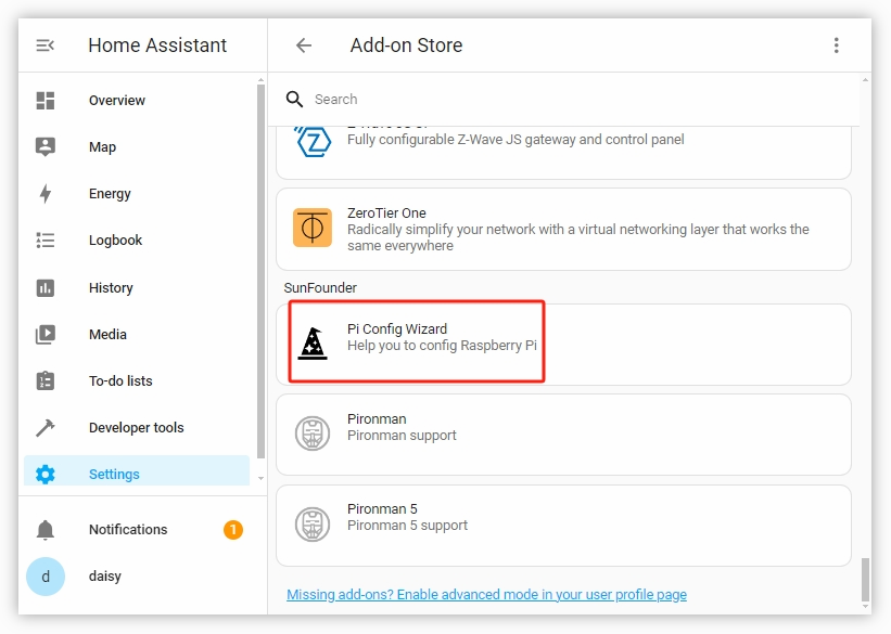

3. Install the Pi Config Wizard Add-on
The Pi Config Wizard can help enable the configurations needed for Pironman 5 Mini, such as I2C and SPI. If not needed afterward, it can be removed.
  1. Find Pi Config Wizard in the SunFounder add-ons list and click to enter.

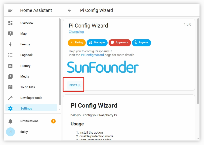

  2. On the Pi Config Wizard page, click INSTALL. Wait for the installation to complete.
    ../../_images/home_config_install2.png

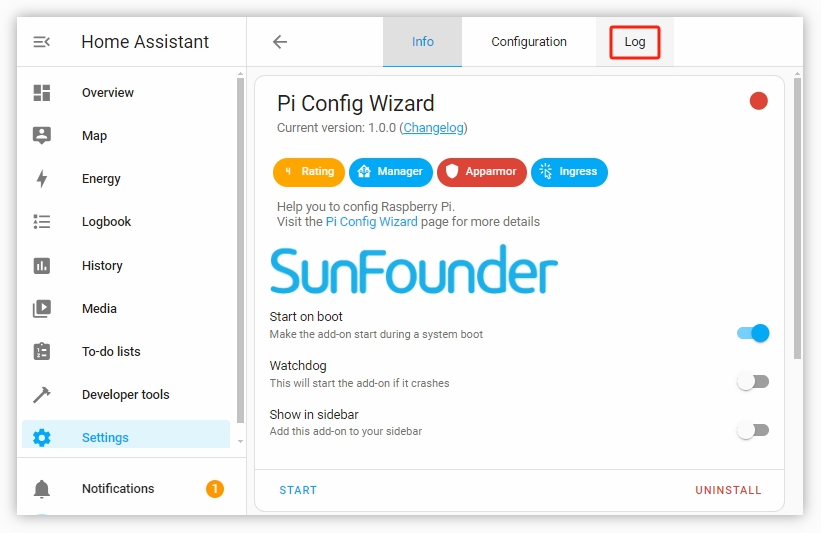

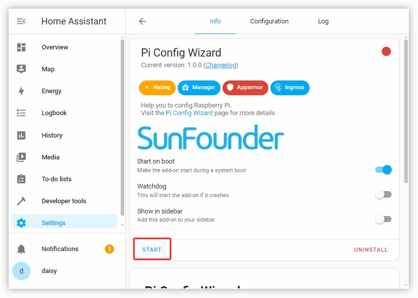

  3. After the installation is complete, switch to the Log page to confirm if there are any errors.
    ../../_images/home_log2.png

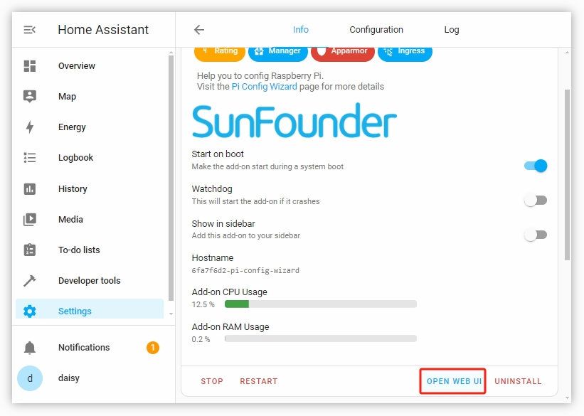

  4. If there are no errors, return to the Info page and click START to start this add-on.
    ../../_images/home_start2.png
  5. Now open the WEB UI.
    ../../_images/home_open_web_ui2.png

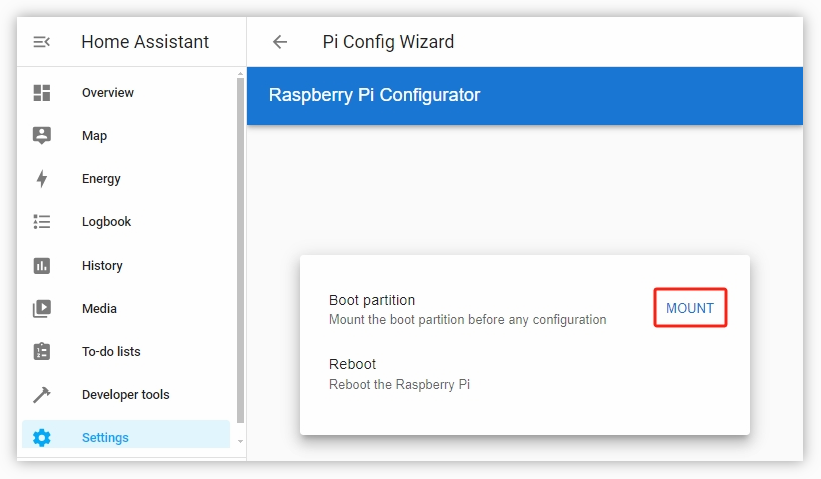

  6. In the Web UI, you will see an option to mount the Boot partition. Click MOUNT to mount the partition.
    ../../_images/home_mount_boot2.png

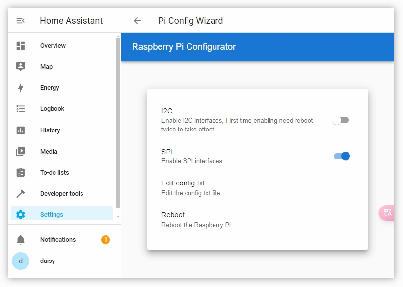

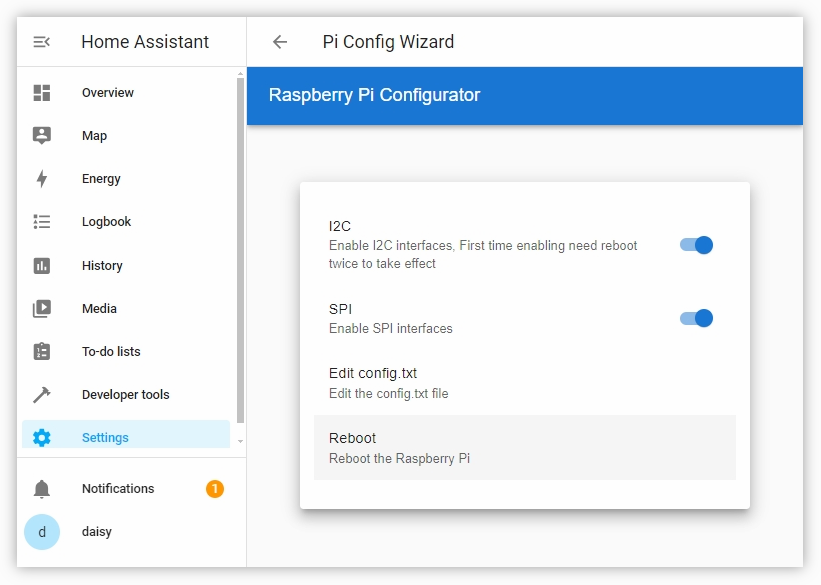

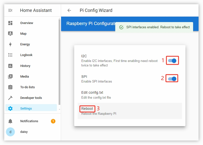

  7. After successful mounting, you will see options to set I2C, SPI, and edit the config.txt file. Check I2C and SPI to enable them. Once they show as enabled, click the reboot button at the bottom to restart the Raspberry Pi.
    ../../_images/home_i2c_spi2.png

  9. Usually, you will see that SPI is enabled, but I2C is not because I2C requires two reboots. Enable I2C again, then restart the Raspberry Pi.
    ../../_images/home_enable_i2c2.png
  10. After the reboot, return to the MOUNT page again. You will see that both I2C and SPI are enabled.
    ../../_images/home_i2c_spi_enable2.png

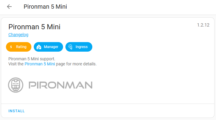

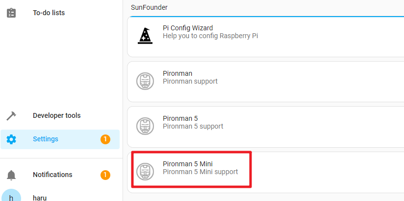

  3. Find Pironman 5 Mini in the SunFounder add-ons list and click to enter.
    ../../_images/home_pironman5_mini_addon.png

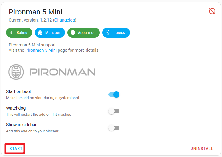

  4. Now install the Pironman 5 Mini add-on.
    ../../_images/home_pironman5_mini_addon_install.png
  5. After installation is complete, click START to start this add-on. You will see Four WS2812 RGB LEDs will light up in blue with a breathing mode.

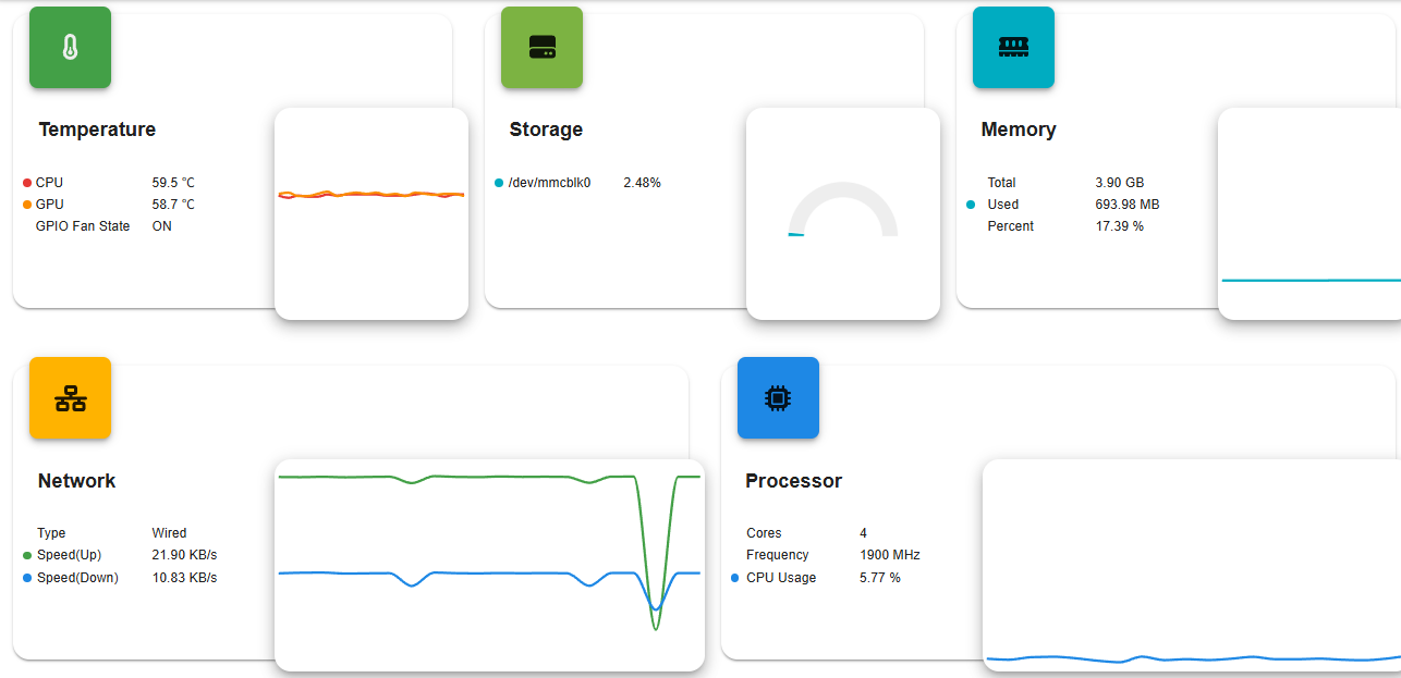

  7. Now you can see the information about your Raspberry Pi, configure the RGB, and control the fan, etc.
