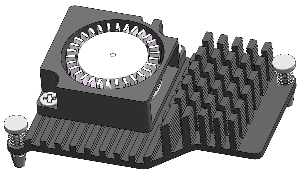

Active Cooler
The Active Cooler on the Pironman 5 Mini is controlled by the Raspberry Pi system.
../../_images/active_cooler.png
Regarding cooling solutions for the Raspberry Pi 5, especially under heavy load, the design of the Pironman 5 Mini incorporates a smart cooling system. It features a primary Active Cooler (active cooler) and a supplementary RGB fan. The cooling strategy is closely integrated with the Raspberry Pi 5’s thermal management system.
The Active Cooler’s operation is based on the Raspberry Pi 5’s temperature:
  • Below 50°C, the Active Cooler remains off (0% speed).
  • At 50°C, the fan starts at a low speed (30% speed).
  • Reaching 60°C, the fan increases to a medium speed (50% speed).
  • At 67.5°C, the fan ramps up to a high speed (70% speed).
  • At 75°C and above, the fan operates at full speed (100% speed).
This temperature-to-speed relationship also applies when the temperature decreases, with a 5°C hysteresis. The fan speed reduces when the temperature falls 5°C below each of these thresholds.
  • Commands to monitor the Active Cooler. To check the Active Cooler’s status:
  • To view the Active Cooler’s speed:
In the Pironman 5 Mini, the Active Cooler is a critical component for maintaining optimal operating temperatures, particularly during intensive tasks, ensuring the Raspberry Pi 5 runs efficiently and reliably.
