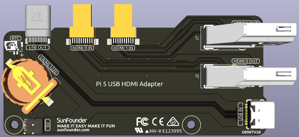

This USB HDMI adapter board is specifically designed for the Raspberry Pi 5. Its primary function is to reposition the USB and HDMI connections to align with the USB interface side of the Raspberry Pi, enhancing accessibility and cable management.
Additionally, the HDMI port is converted to a standard HDMI Type A interface, offering broader compatibility.
NVMe Additional Power Supply
The board features a 5V power header specifically for NVMe PIP power supply. Coupled with an extension header, it can be connected to the NVMe’s additional power interface to provide extra power.
1220RTC Battery Holder
A 1220RTC battery holder is incorporated for convenient installation of an RTC battery. It connects to the Raspberry Pi’s RTC interface via an SH1.0 2P reverse cable.
The battery holder is compatible with both CR1220 and ML1220 batteries. If using an ML1220 (Lithium Manganese Dioxide battery), charging can be configured directly on the Raspberry Pi. Note that the CR1220 is not rechargeable.
