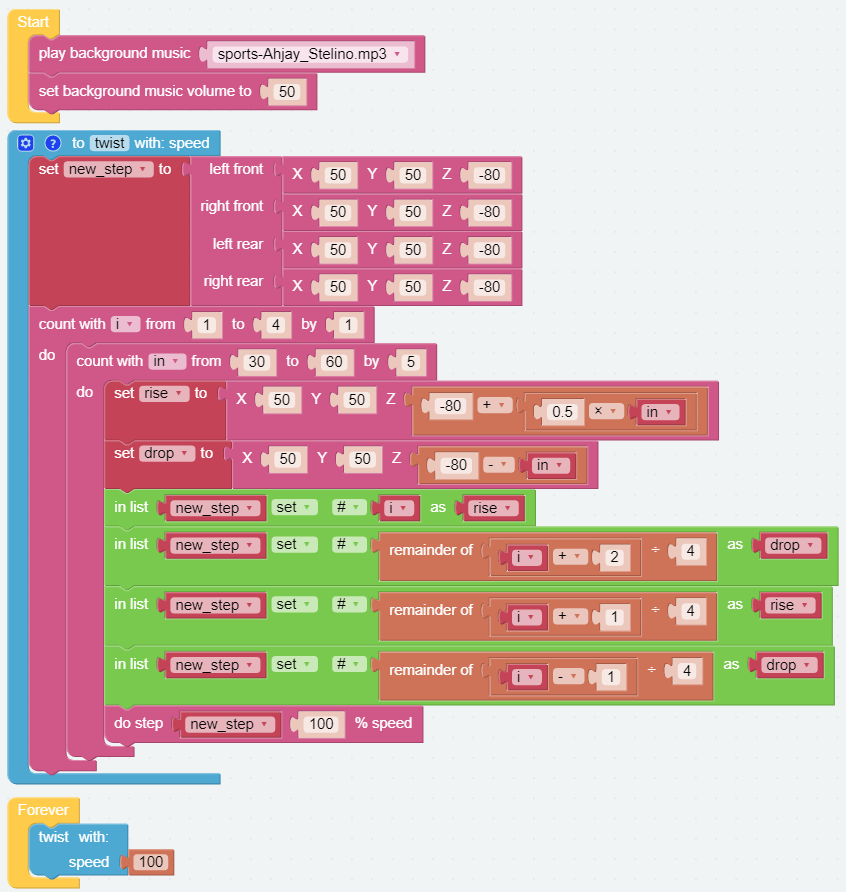

We already know how to make PiCrawler assume a specific pose, the next step is to combine the poses to form a continuous action.
Here, PiCrawler's four feet are up and down in twos, jumping with the music.
Program
  • You can write the program according to the following picture, please refer to the tutorial: How to Create a New Project?.
  • Or find the code with the same name on the Examples page of the EzBlock Studio and click Run or Edit directly.
../_images/twist.png
How it works?
It uses two layers of for loops to make the new_step array produce continuous and regular changes, and at the same time, do step executes the posture to form a continuous action.

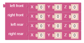

You can intuitively get the coordinate value array corresponding to each pose from Adjust Posture.
One thing you need to pay attention to is this coordinate matrix block:
../_images/sp210928_154257.png
It is essentially a two-dimensional array, which can be processed by blocks in the List category. Its structure is [[right front],[left front],[left rear],[right rear]]. In other words, in this example, new_step#1 corresponds to the right front; new_step#2 corresponds to the left front; new_step#3 corresponds to the left rear; and new_step#4 corresponds to right rear.
