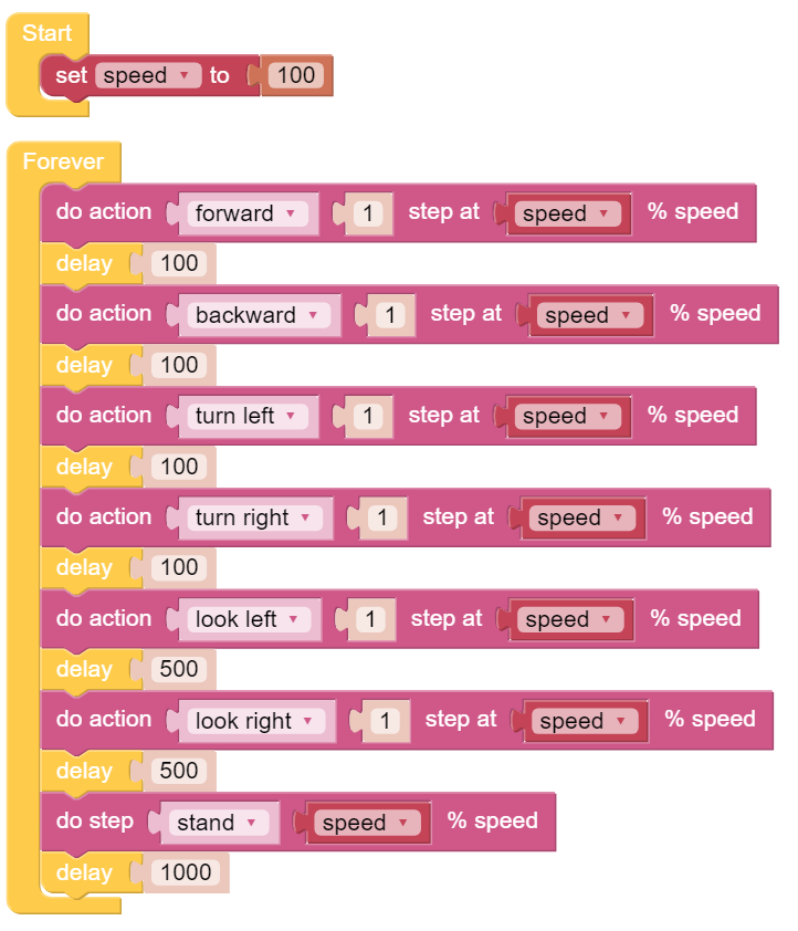

  • You can write the program according to the following picture, please refer to the tutorial: How to Create a New Project?.
  • Or find the code with the same name on the Examples page of the EzBlock Studio and click Run or Edit directly.
../_images/move1.png
Click the Upload & Run button at the bottom right of the screen, and PiCrawler will execute "forward" and "backward" actions in sequence.

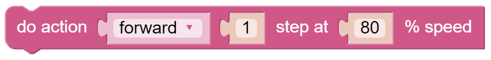

do action allows PiCrawler to perform basic actions. You can modify the options in the first groove. For example, select "Turn Left", "Back" and so on. The second groove can set the number of executions of the action, and only integer numbers greater than 0 can be written. The third groove can set the speed of the action, and only integers within 0~100 can be written.

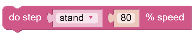

do step is similar to do action, but it is not an action but a static posture. Such as "stand", "sit".
Both blocks can be dragged from the PiCrawler category on the left.
