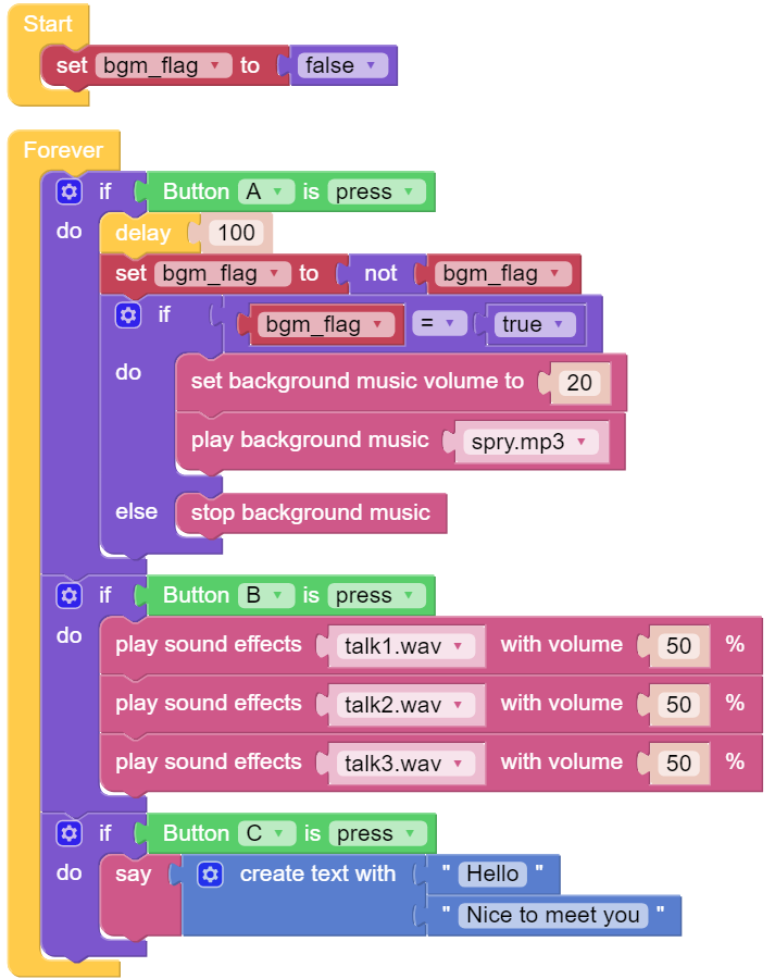

  • You can write the program according to the following picture, please refer to the tutorial: How to Create a New Project?.
  • Or find the code with the same name on the Examples page of the EzBlock Studio and click Run or Edit directly.
../_images/soundeff.png

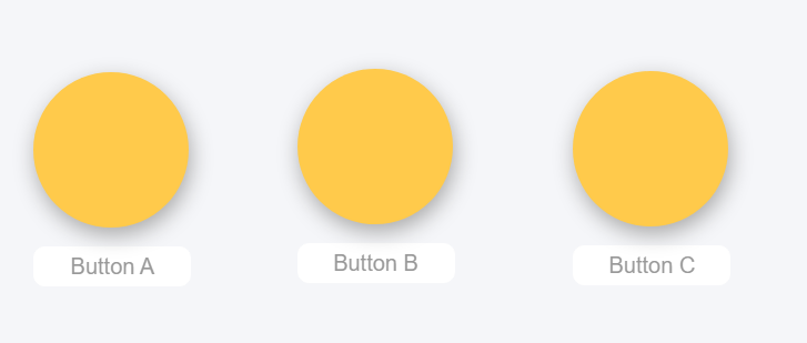

Switch to the Remote Control interface, and you will see the following widgets.
../_images/soundeff_B.png
After the program is running, you can press different buttons to make PiCrawler sound.

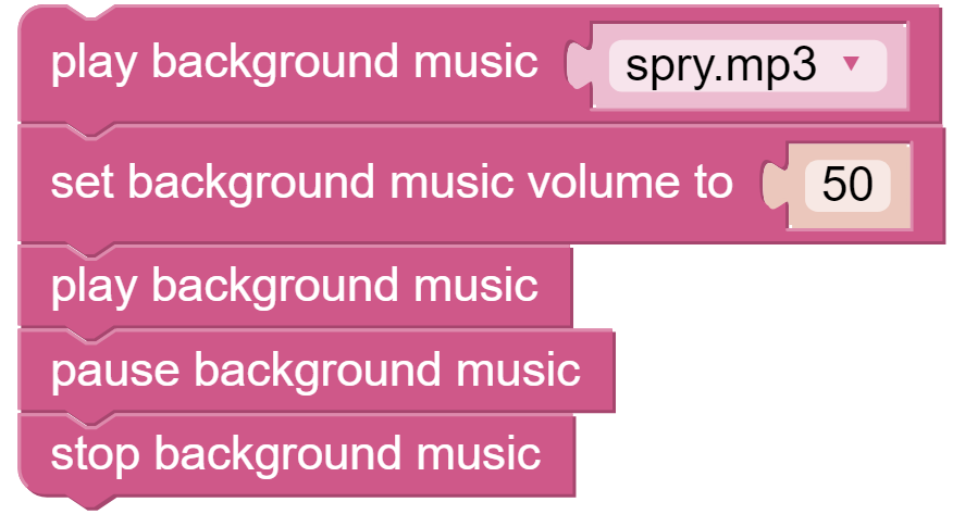

Functions related to background music include these:
../_images/sp210928_101816.png

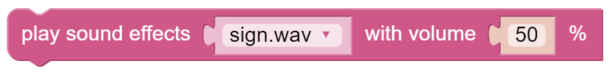

Functions related to sound effects include these:
../_images/sp210928_101727.png

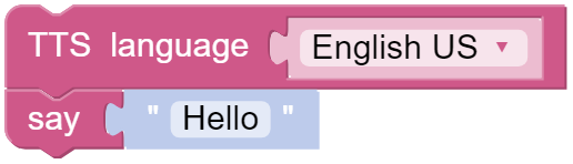

Functions related to Text to Speech include these:
../_images/sp210928_101609.png
