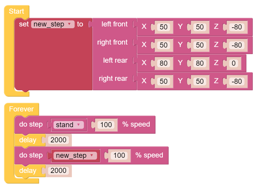

  • You can write the program according to the following picture, please refer to the tutorial: How to Create a New Project?.
  • Or find the code with the same name on the Examples page of the EzBlock Studio and click Run or Edit directly.
../_images/dostep.png

In this code, the code you need to pay attention to is this do step.
It has two uses:
One: It can directly use stand or sit.
Second: It can also write an array of 4 coordinate values.
Each foot has an independent coordinate system. As shown below:
../_images/4cood.png
You need to measure the coordinates of each toe individually. As shown below:
../_images/1cood.png
