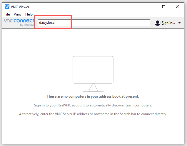

  2. Open RealVNC Viewer, then enter your Raspberry Pi’s IP address or <hostname>.local and press Enter.
    ../../_images/ssh_vnc_login.png

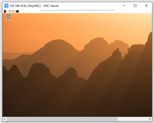

  4. You should now see the Raspberry Pi desktop:
    ../../_images/ssh_vnc_desktop.png
