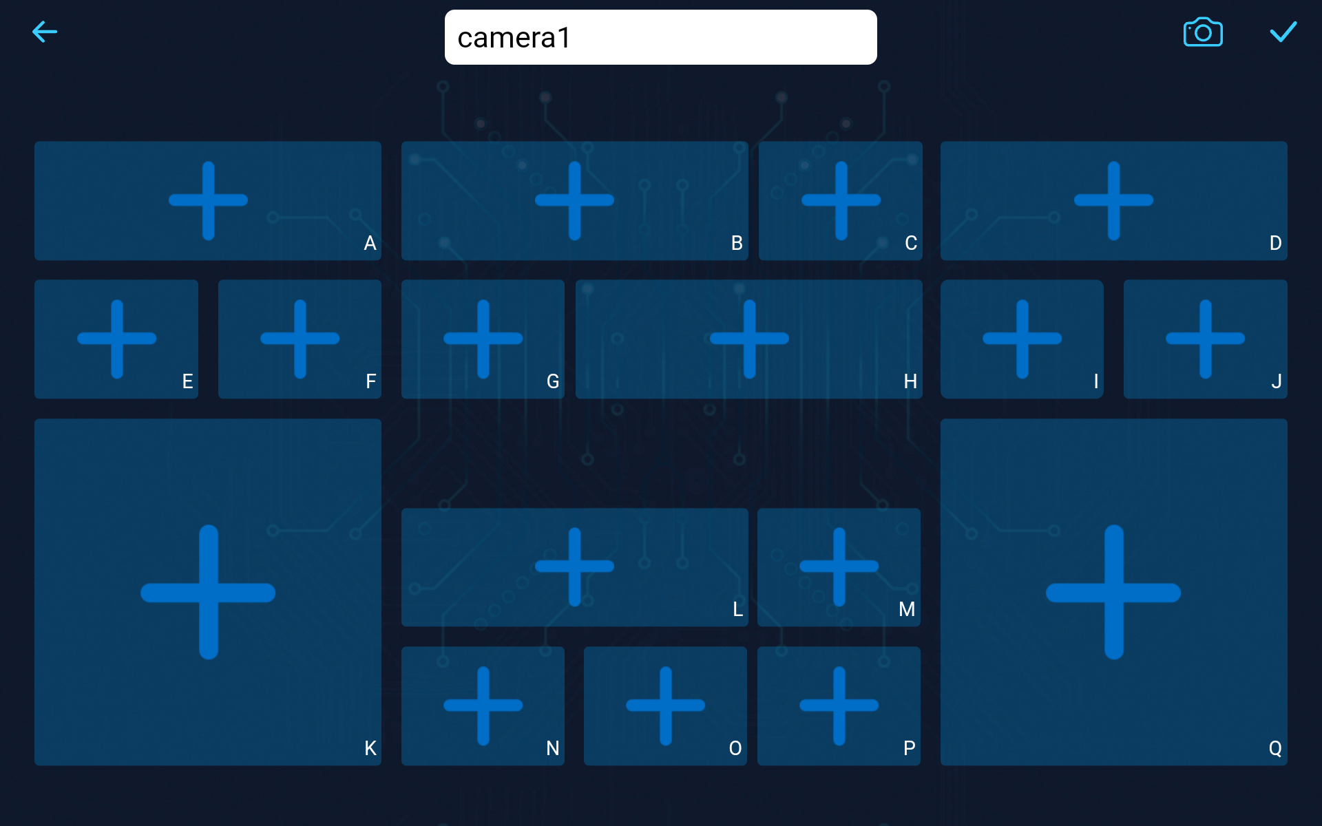

On creating a new controller, you’ll be met with a screen that might look like an enigma at first.
You’ll see a kaleidoscope of shapes: long rectangles, short rectangles, and large squares, each uniquely tagged with identifiers from A to Q.
Ever wondered why such diversity? What do the identifiers A to Q imply?
Let’s embark on this exploratory journey!

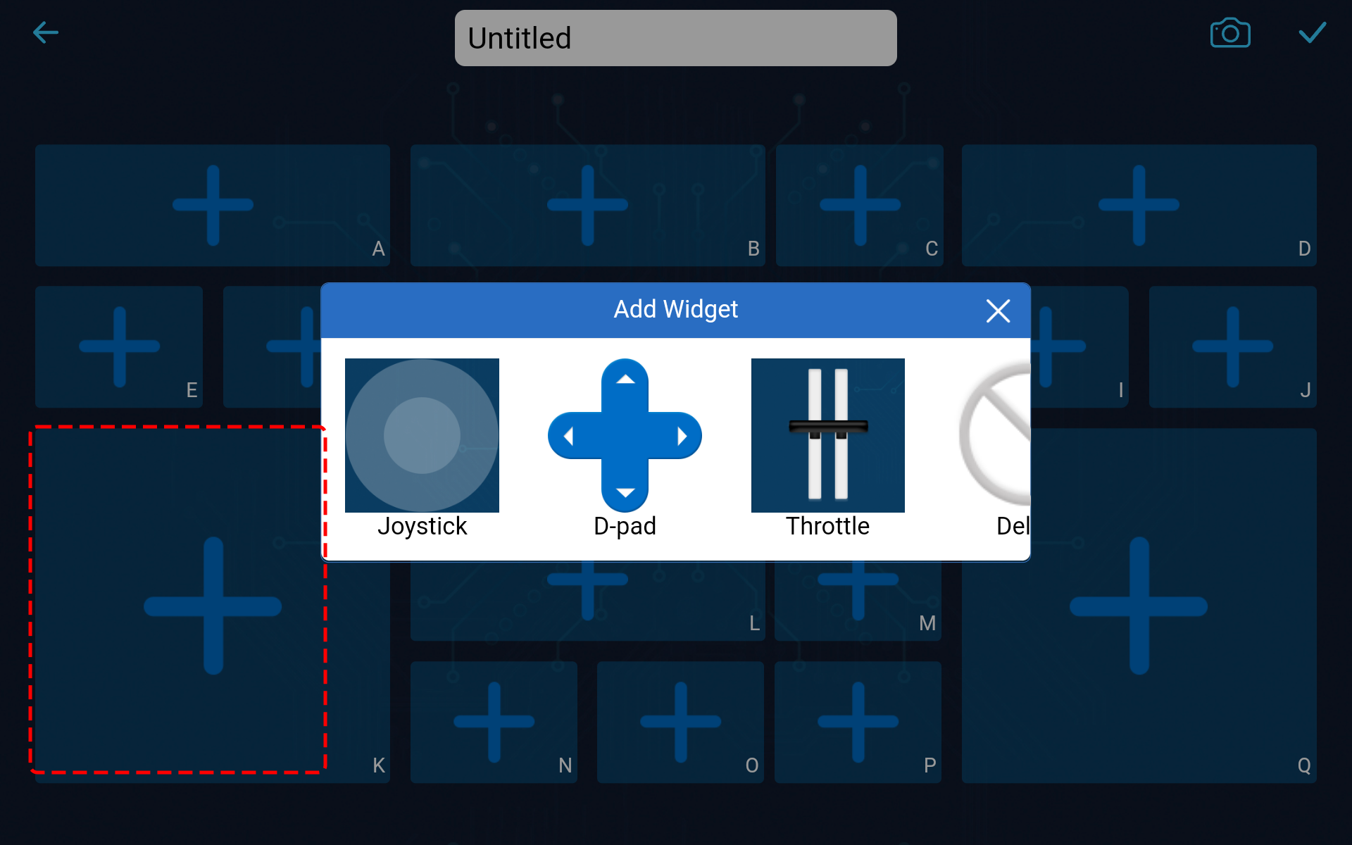

Deciphering the Shapes

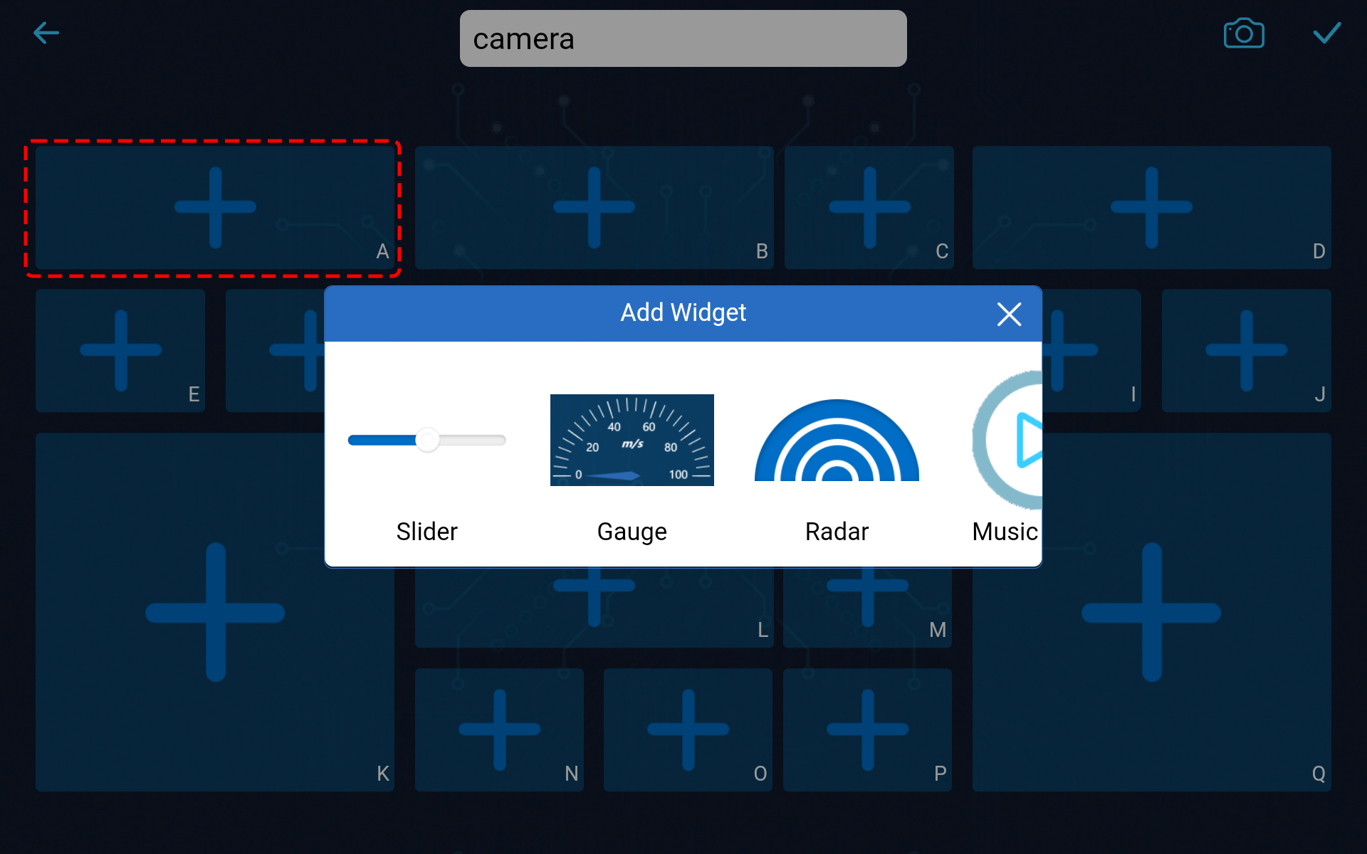

For instance, tap on a long rectangular area. Like opening a treasure chest, you’ll unveil several widgets. Remember the Slider from our previous class? Swiping it left or right controlled the Mars rover’s camera tilt. Then there’s the Gauge, can be used as your rover’s personal speedometer. And a plethora of other widgets!

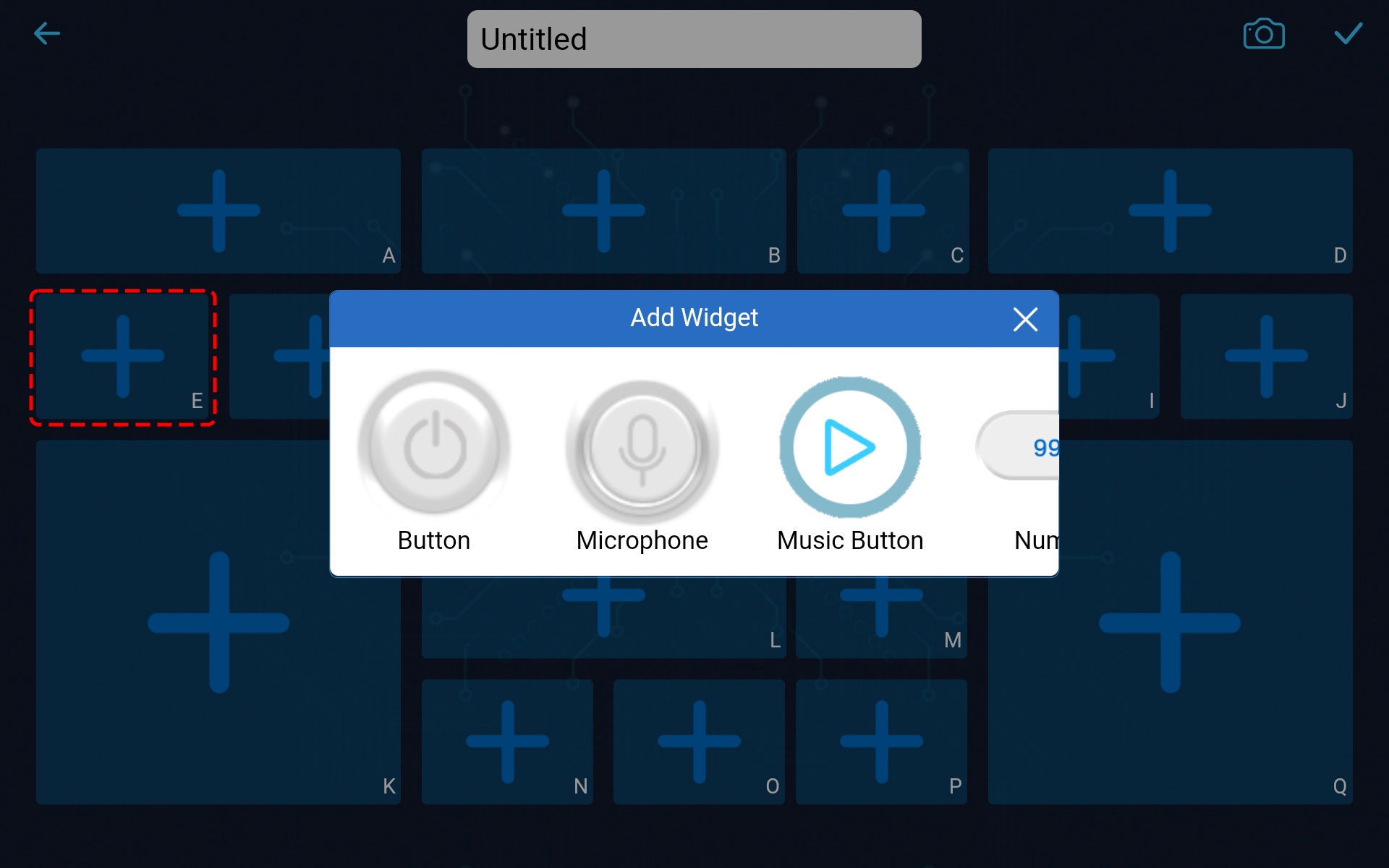

Tap on the shorter rectangle, and it reveals a different set of widgets. The Button widget, like a binary switch, issues singular commands, while the Microphone widget can listens to your voice commands to control the rover, among other widgets.
What about the square block, you ask? It houses the Joystick widget, the D-pad widget, and the Throttle widget. And yes, there’s more!
At this point, don’t fret about each widget’s function or usage. Familiarize yourself with what widgets each shape houses.

Every shape carries an identifier on the bottom right corner. Why, you ask? Let’s understand this with an example.
In our last class, we added a Slider widget in the D region. The code to get its value looked something like this:
int16_t sliderD = aiCam.getSlider(REGION_D);
What if we added a Slider widget in the B region? How would the code change? As simple as replacing
REGION_DwithREGION_B.int16_t sliderD = aiCam.getSlider(REGION_B);
Easy, right? These identifiers help discern which widget you’ve added in which area.

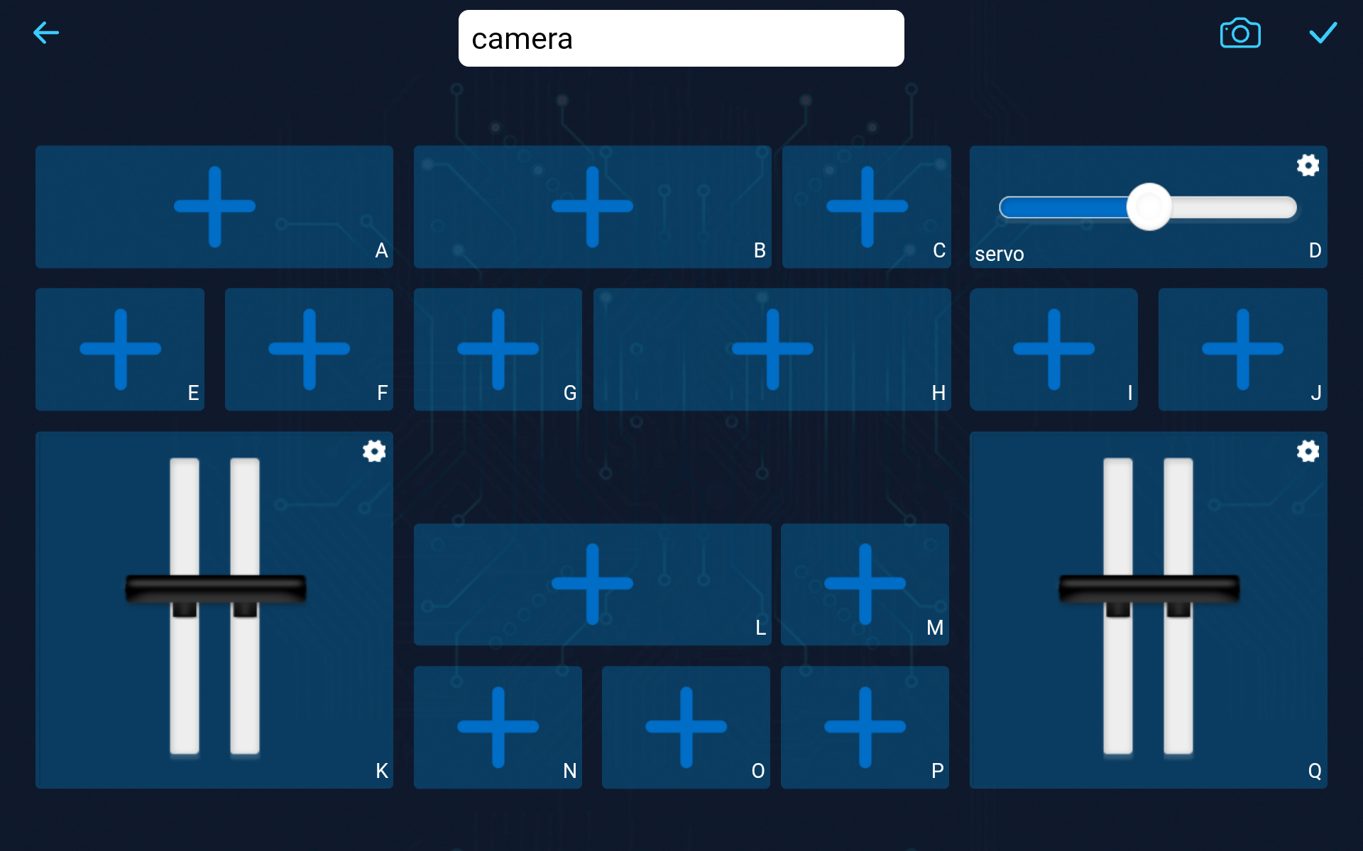

Place a Throttle widget each in the K and Q regions. You will need to hit the
button at the top right to switch to editing mode, and once you’re done setting things up, click
to store your changes.

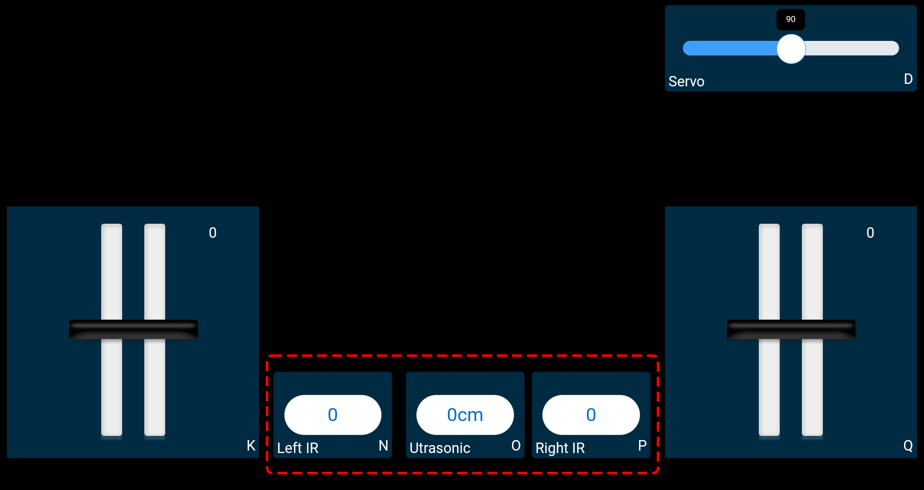

Get started by adding three Number widgets to your SunFounder Controller. Don’t forget, you can personalize their names and units using the settings button.
Next, let’s delve into the code. Start by bringing over the IR avoidance modules and ultrasonic module code snippets from our previous lessons.
... // Define the pin for the ultrasonic module #define ULTRASONIC_PIN 10 // Define the pins for the IR modules #define IR_RIGHT 7 #define IR_LEFT 8 void setup() { ... // Set the IR module pins as inputs pinMode(IR_RIGHT, INPUT); pinMode(IR_LEFT, INPUT); } float readSensorData() { // A 4ms delay is required, otherwise the reading may be 0 delay(4); //Set to OUTPUT to send signal pinMode(ULTRASONIC_PIN, OUTPUT); ... }
In the
onReceive()function, extract the values from the avoidance modules and the ultrasonic sensor. Subsequently, update these values in thesendDoc[]dictionary. TheN,P, andOkeys correspond to the region codes of the three Number widgets you’ve added.// Function to execute when data is received from the Controller void onReceive() { ... // Read values from IR sensors int leftValue = digitalRead(IR_LEFT); int rightValue = digitalRead(IR_RIGHT); aiCam.sendDoc["N"] = leftValue; aiCam.sendDoc["P"] = rightValue; // ultrasonic float distance = readSensorData(); aiCam.sendDoc["O"] = distance; }
Here is the complete code:
Once the code has been successfully uploaded, get your SunFounder Controller up and running. You’ll be greeted with the real-time values of the avoidance modules and the distance detected by the ultrasonic sensor, painting a clear picture of the rover’s immediate environment.
