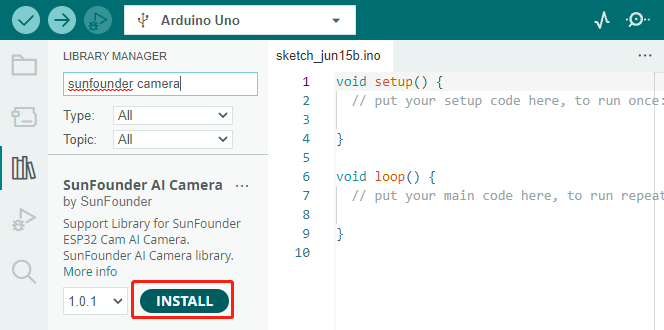

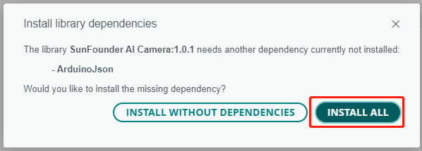

  1. Install the SunFounder AI Camera library.
    • Open the Arduino IDE’s Library Manager, search for “SunFounder Camera”, and click INSTALL.
      _images/camera_install_lib.png
    • A pop-up window will appear for the installation of library dependencies. Click INSTALL ALL and wait for the process to complete.

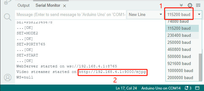

    • Open the Serial Monitor and set the baud rate to 115200. If no information appears, press the Reset button on the GalaxyRVR shield to run the code again. You should see an IP address in the serial monitor output. This is the address your Rover’s camera is broadcasting to.
      _images/camera_serial.png

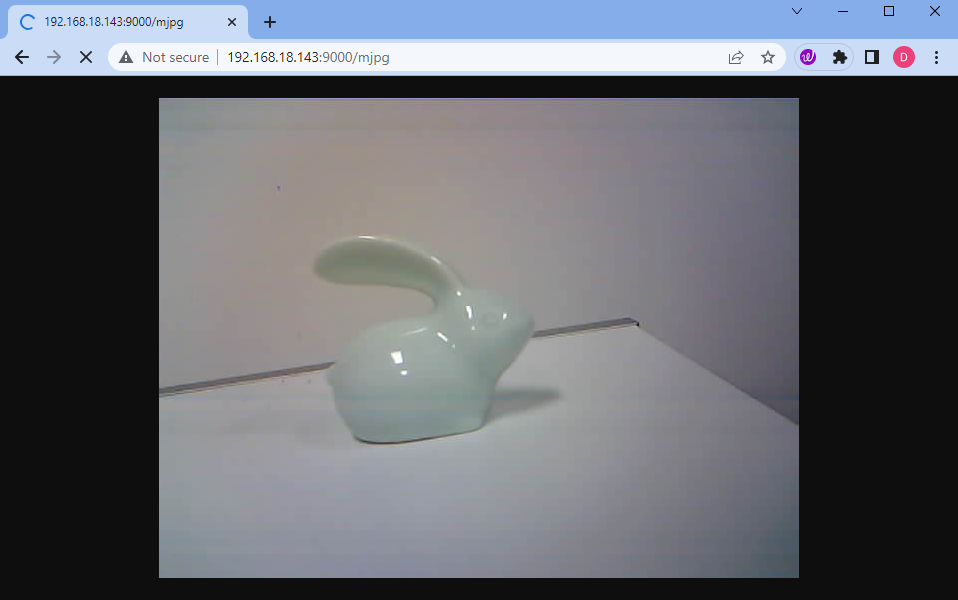

    • Now, it’s time to actually see what our Rover sees! Open up a web browser - we recommend Google Chrome - and enter the URL you see in the Serial Monitor, in the format http://ip:9000/mjpg.
      _images/camera_view.png
And voila! You should now be able to see the live feed from your Rover’s camera. Isn’t it amazing to think that you are viewing Mars (or maybe just your living room) from the Rover’s perspective? Just like a real Mars Rover scientist!

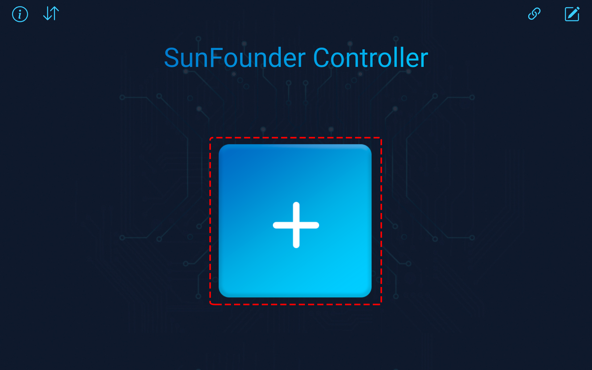

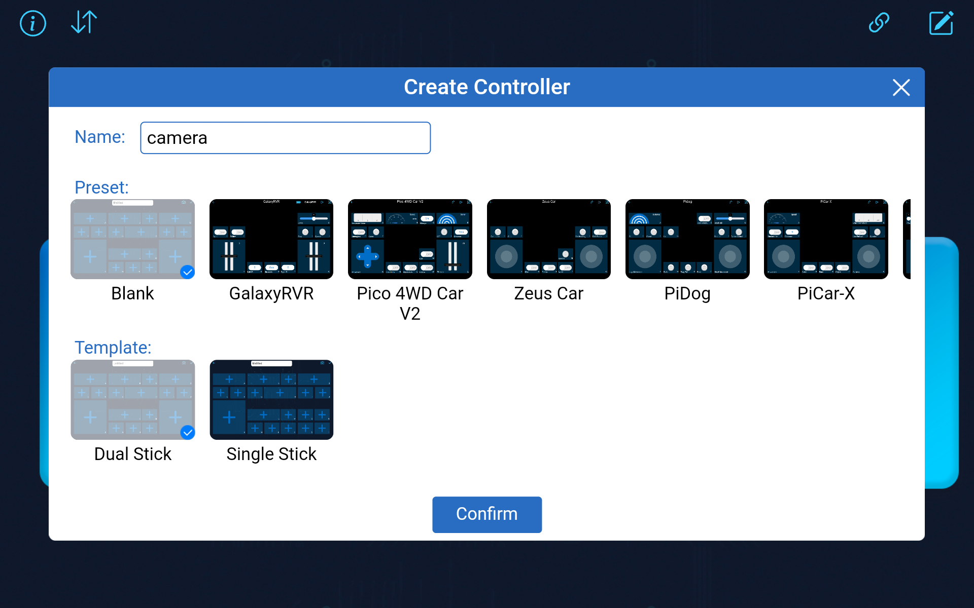

  2. Create a controller.
    • To add a controller on SunFounder Controller, click the + icon.
      _images/app1.png
    • Choose the Blank preset, select either Dual or Single Stick according to your preference. Give your new controller a name and click Confirm.

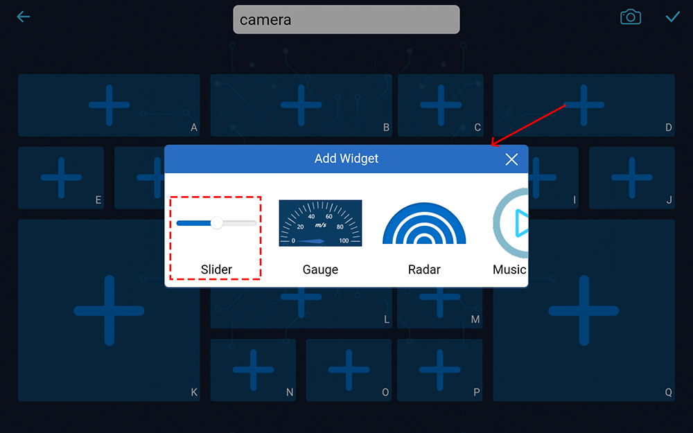

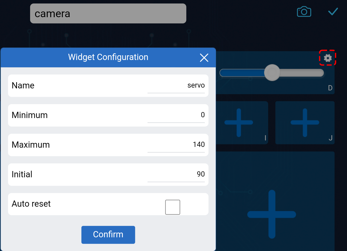

    • You are now inside the controller. Click the + icon in the D section, then select Slider from the popup menu.
    _images/camera_add_slider.png
    • This Slider widget is designed to control the tilt mechanism. As we learned in the previous lesson, its range is from 0 to 140. Therefore, we will set these as the minimum and maximum values for our Slider widget.
      _images/camera_slider_set.png
    • Click the app_save button in the upper right corner to save this controller.

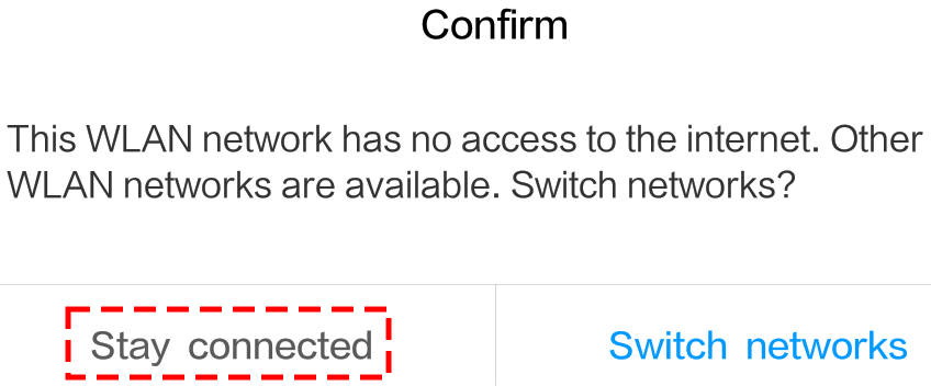

    • The default connection mode is AP mode. After you connect, there may be a prompt warning you that there is no Internet access on this WLAN network, please choose to continue the connection.

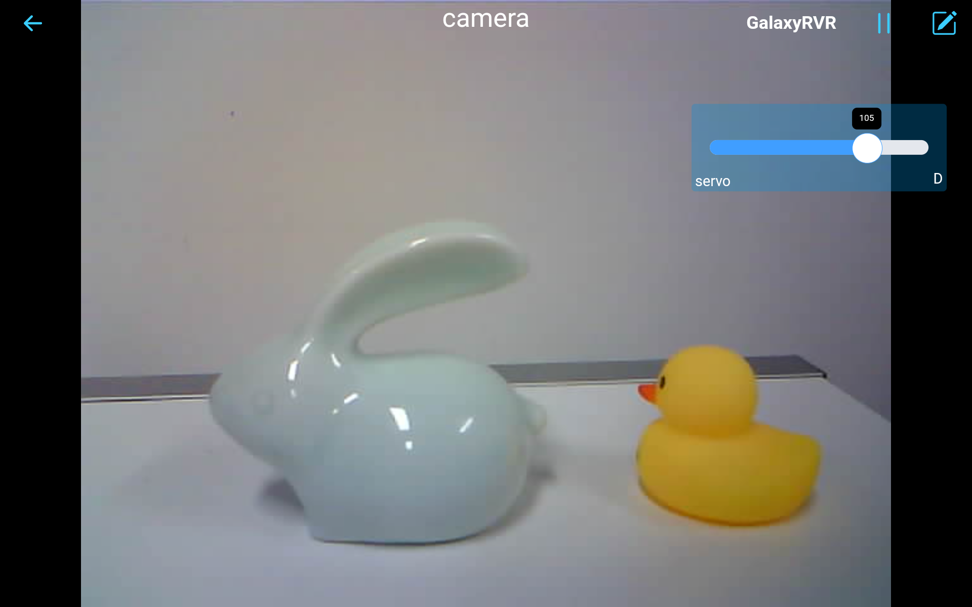

    • Once you see the “Connected Successfully” message, press the app_run button. This will bring up the camera’s live footage on the app.
      _images/camera_view_app.png
    • Now, move the slider and open Arduino IDE’s serial monitor simultaneously. You should see similar data like below.
      Slider D: 105
      WS+null
      Slider D: 105
      WS+null
      Slider D: 105
      WS+null
