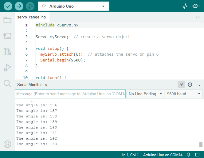

We use a for loop to rotate the servo from 0 to 180 degrees while keeping a note of the angle in the Serial Monitor.
The ESP32-CAM and the Arduino board share the same RX (receive) and TX (transmit) pins. So, before uploading the code, youâll need to first release the ESP32-CAM by slide this switch to right side to avoid any conflicts or potential issues.
After we upload this code, open the Serial Monitor. If no information appears, press the Reset button on the GalaxyRVR shield to run the code again.
You will see the servo rotate, and the Serial Monitor will display the angle.
On my Rover, the tilt mechanism could go up to around 140° before it hit the body of the Rover and couldnât go any further.
