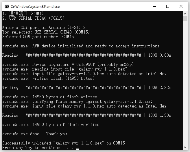

How to Upload the galaxy-rvr.ino Code?
By default, the GalaxyRVR’s Uno R3 board comes preloaded with the necessary firmware, allowing you to control it via APP. If your R3 board has been overwritten with other code, but you’d like to return to the default firmware and continue with the Quick Play with APP process, follow these steps to re-upload the code to your R3 board:

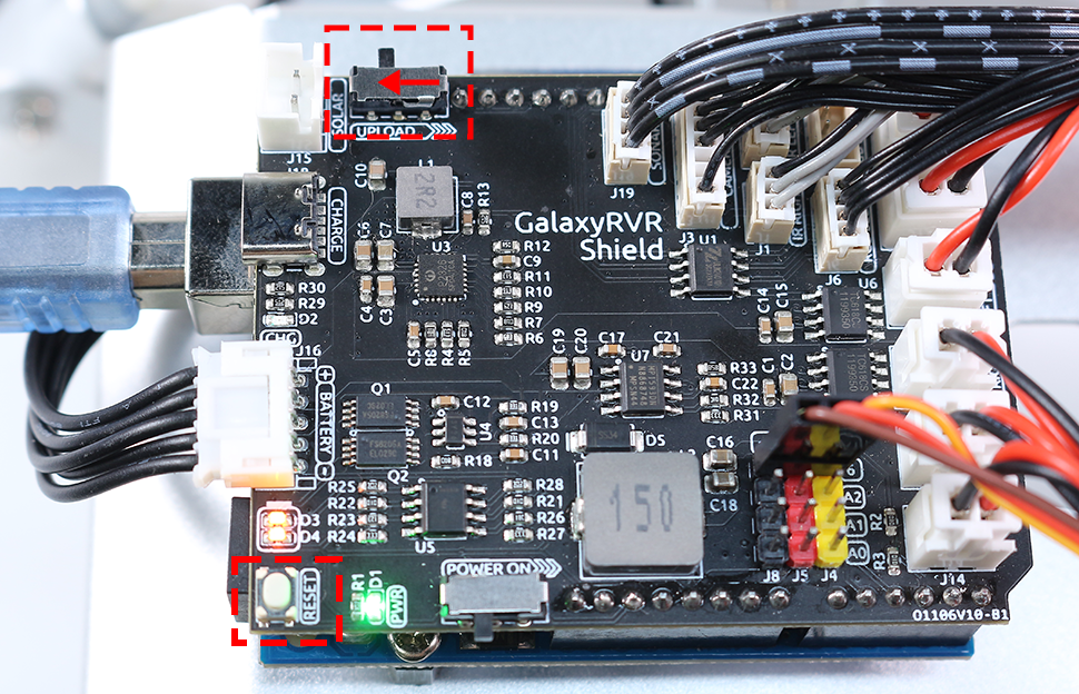

  1. Use a USB cable to connect the Arduino to your computer. Then, switch the upload switch on the rover to the “upload” position.
    _images/camera_upload.png

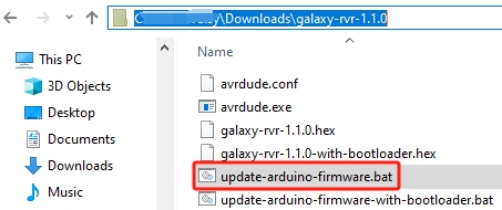

  2. Download the required firmware from the link below:
  3. Extract the downloaded zip file, then double-click the update-arduino-firmware.bat file to run it.
    _images/faq_firmware_file.png

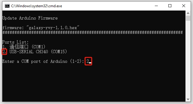

  4. Type the corresponding number for your GalaxyRVR’s Arduino Uno (e.g., 2) and press Enter to begin the update.
    • If the correct COM port does not appear, or if you’re unsure which one it is, disconnect other USB devices from your computer, leaving only the rover connected.
    • If you encounter an error like “avrdude.exe: stk500_getsync() attempt 1 of 10: not in sync: resp=0xXX”, ensure the upload switch on the rover is set to the “upload” position, as described in step 1.
    _images/faq_firmware_port.png
  5. After a short while, the new code will be successfully uploaded to the Uno R3 board on GalaxyRVR.
    _images/faq_firmware_finish.png

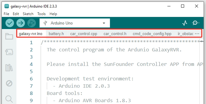

  4. Navigate to the galaxy-rvr-main\galaxy-rvr directory and open the galaxy-rvr.ino file.
    _images/faq_galaxy_code.png

  6. Connect the GalaxyRVR and computer with a USB cable, and then turn the upload switch of the rover to the upload end.

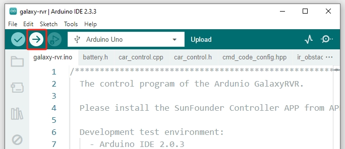

  7. Click the Upload button in the Arduino IDE to upload the modified code to the Uno board.
    _images/faq_galaxy_upload.png

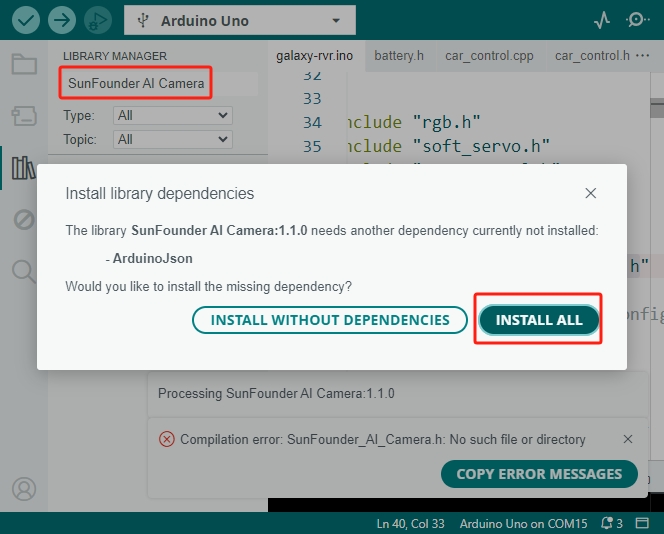

Compilation error: SoftPWM.h or SunFounder_AI_Camera.h: No such file or directory?
If you get a “Compilation error: SoftPWM.h: No such file or directory” prompt, it means you don’t have the SoftPWM library installed.
Please install the two required libraries SoftPWM and SunFounder AI Camera as shown.
For the SunFounder AI Camera library, you need to select “INSTALL ALL” to simultaneously install the required ArduinoJson dependency.
_images/faq_install_ai_camera.png
