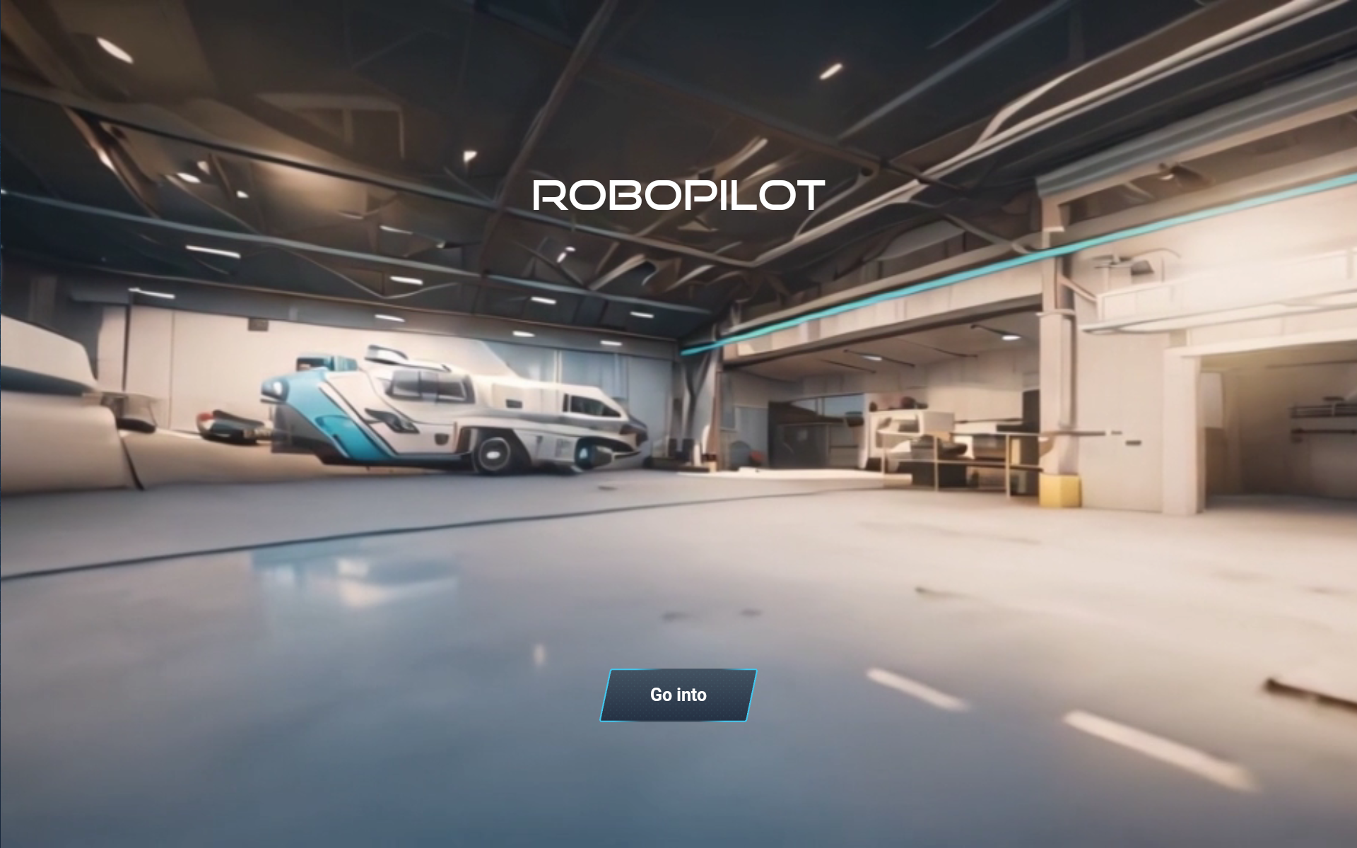

  4. Open RoboPilot. Click ‘Go into’ to enter the control interface.

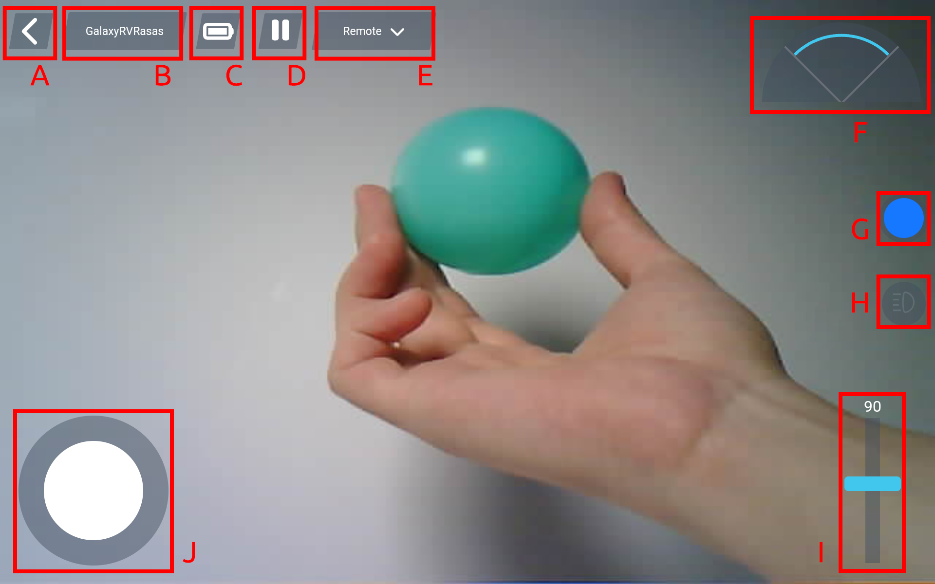

Remote Mode
Upon entering the control interface, you will see the following screen. The background shows the view captured by the GalaxyRVR’s camera, with remote control widgets overlaid.
../_images/rp2_page.png
Here are the controls:
  1. Back

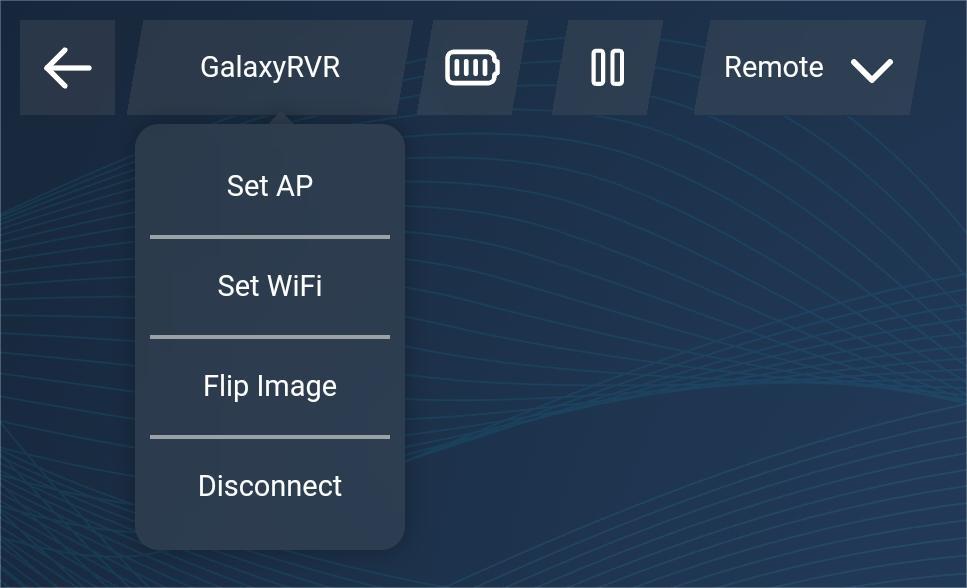

  2. Settings: Here you can change the name and password of the AP (hotspot), set up WiFi, flip the image, and disconnect.
    ../_images/rp3_setting.jpg
  3. Battery level indicator
  4. Pause/Run the APP

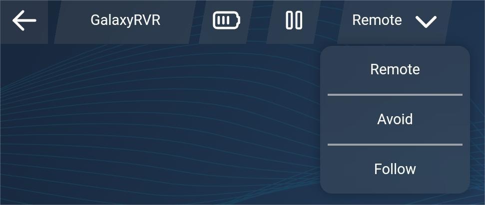

  5. Mode Selection: Here you can choose between Remote Mode, Avoid Mode, and Follow Mode. The default setting is Remote Mode.
    ../_images/rp4_mode.jpg
  6. Obstacle monitor: This module is divided into three areas, with the left and right sides showing the results from the obstacle modules, and the central area displaying the ultrasonic sensor’s findings.

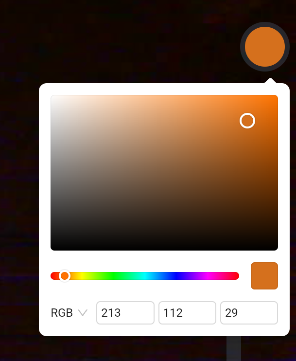

  7. Color selector: Choose the lighting color for the chassis here.
    ../_images/rp5_color.png
  8. Camera LED switch.
  9. Adjust the gimbal angle, ranging from 0-130°. At 0°, it looks up at the sky.
  10. Move the joystick to control the movement of GalaxyRVR. A gentle push will make the GalaxyRVR move slowly.
Avoid Mode & Follow Mode
  • Avoid Mode: the GalaxyRVR will move forward and avoid obstacles in its path.
  • Follow Mode: the GalaxyRVR will move towards an object in front of it or turn left or right to follow the object’s movement.

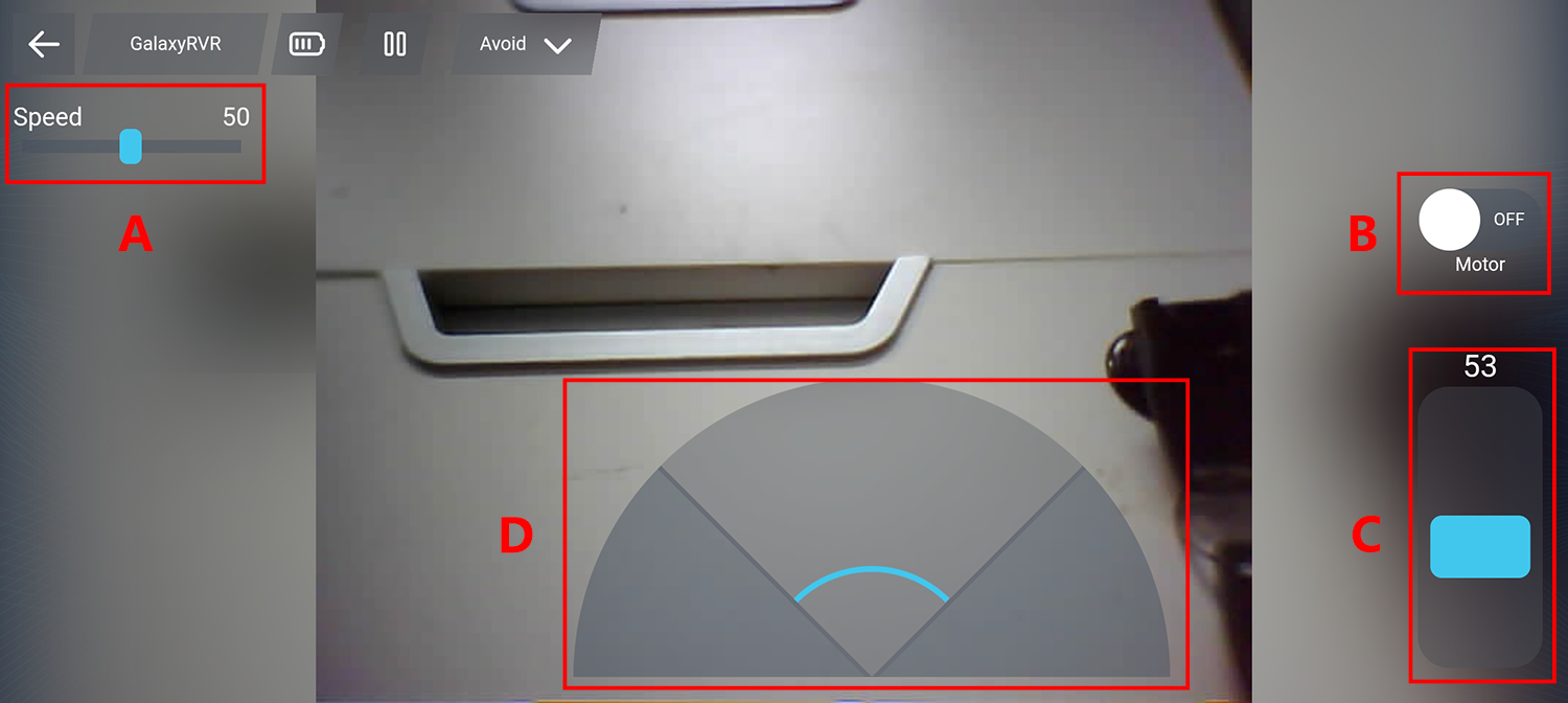

When you select Avoid Mode or Follow Mode, you’ll see the interface below. The live camera view from GalaxyRVR forms the background, with control options overlaid on top.
../_images/rp6_avoid.png
Interface Controls:
  1. Speed Control - Adjust GalaxyRVR’s movement speed
  2. Motor Control - Start or stop GalaxyRVR’s movement
  3. Gimbal Control - Adjust camera angle from 0° (facing sky) to 130°
  4. Obstacle Monitor - Visual feedback from sensors:
    • Left/right sections: Infrared obstacle detection
    • Center section: Ultrasonic distance measurements

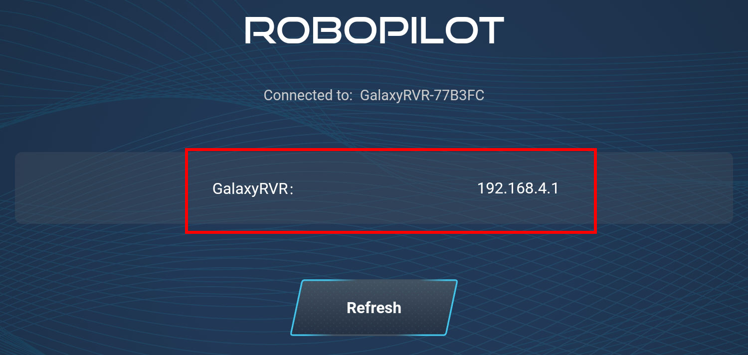

Re-connect
If your network fails or disconnects, you will be directed to this page.
../_images/rp7_reconnect.png
At this point, please reset your network settings, then click on the IP corresponding to your GalaxyRVR to reconnect.
